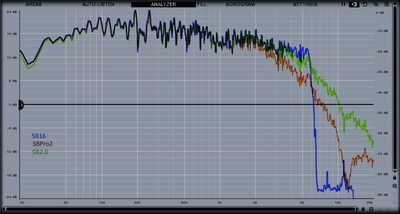

Reply 12 of 30, by James-F
Yes the SB16 indeed sounds brighter, yet more filtered (smoother) at the same time.
The SB16 (also AWE32 and AWE64) filters everything above 5.5kHz (11kHz sampling rate), while the other cards have passive roll-off filter which is fixed.
The SBPro2 is the most filtered while the SB2.0 is the least, the SB1.5 somewhere in between (not shown).
SB16 and SBPro2 have almost 15db difference at 5kHz, while having the same frequency response below 1kHz on all of them.
The sound card indeed makes difference in how your DOS games will sound, something that DOSBox is not capable yet to emulate authentically.
91.54 KiB
10591 views
PS.
Please don't change Capacitors expecting "better low-end", in reality it does nothing.
All the cards are at least 20 years old, yet measure absolutely the same below 1kHz with stock capacitors.

Fantastic work! Especially the graphs show what's really going on.
Looking at the graph, the SB16 let's a bit more of the "good highs" through, and then filters out the "bad highs" very thoroughly.

Thanks!
Yes indeed, a brickwall filter is actually still used in ALL modern audio equipment from cheapest MP3/CD Player to most expensive studio equipment.
In 44.1kHz (CD quality) for example, the brickwall filters out anything above 20kHz at the edge of our human range.
This to avoid DAC (digital-to-analog conversion) aliasing.

Yea, and that's where the 'problem' lies. It sounds different from the earlier SBs.
If you're used to how a game sounds on an early SB, then the extra high frequencies will sound 'wrong'. In fact, when creating the music and sound effects for the game, they probably tuned it for how an SB sounds, which may have made them boost the high frequencies somewhat.
On the SB16 it will sound 'overly bright'.
What I find interesting to see is that the SB16 has no signal at all above 15 Khz... The SB2.0 and Pro both seem to 'bleed' all sorts of weird aliasing in these high frequencies. Their designs are pretty cheap and flawed.

Yeah, I concur.
That's why I run both the SB16 and SBPro2 side by side on different addresses for maximum flexibility.
For newer games using auto-init DMA with versatile setup utilities I direct them to the SB16 (240 5 0), while older games by default go for the SBPro (220 7 1).
The SB16 in this example is at 11kHz sampling rate, but at 44.1kHz all the frequencies are there 20-20kHz and it sounds (and measures) quite good in Win98SE playing MP3.
Part of the "secret sauce" of the early SB sound (with passive filtering) is the in-band aliasing when playing lower sampling rate audio like most DOS games.
Definitely cheap and flawed by todays standards but for a DOS sound card lover like myself, this is an authentic treasure.
