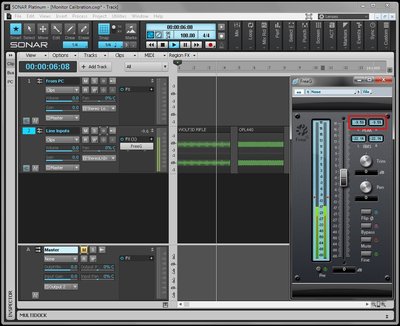

New results for comparison between classic SB cards and DOSBox using a more accurate test than MPXPlayer,
I discovered that on my system MPXPlayer will not behave properly with a SB1 CT1320C card so I found a better source for PCM sound that translates between cards much better than MPXPlayer.
The new PCM reference is a constant Rifle (weapon 3) shot in Wolf3D with music and fx disabled..
SB1.5 CT1320C PCM: -7.70 wolf3d rifle 3 OPL: -13.31 opl440 d: 5.61 […]
SB1.5 CT1320C
OPL: -13.31 opl440
d: 5.61
SB2.0 CT1350B
PCM: -10.07 wolf3d rifle 3
OPL: -15.80 opl440.
d: 5.73
SBPro2 CT1600
PCM: -16.74
OPL: -21.4
d: 4.66
SB16 CT2230
PCM: -6.57
OPL: -11.66
d: 5.09
Audician 32
PCM: -5.3
OPL3: -9.3
d: 4.0 (OPL is louder than SBPro2).
Aztech Sound Galaxy AZT2316 (Multimedia Pro 16 ABI).
PCM: -17.04
OPL3: -22.33
d: 5.29 (very nice balance).
DOSBox 200 (vanilla 0.74).
Shot: -9.6
OPL3: -12.06, -12.04, -12.66 (nuked, compat, fast)
d: 2.44
DOSBox 150
Shot: -9.6
OPL3: -15.55, -14.54, -15.15
d: 4.95
DOSBox 140
Shot: -9.6
OPL3: -15.15, -15.14, -15.75
d: 5.55
Since DOSBox has a filter on the PCM (SB) that sounds closer to the SB1/2 I will choose 140 as the standard FM volume value.
Info:
the d value is the peak difference between FM and PCM.
PCM: Constant Rifle (weapon 3) shot in Wolf3D with music and sound FX muted (none).
FM: opl440.com test software.
The 140/150 value after DOSBox is a volume level for FM only in a DOSBox SVN test build.
I just measure peaks on a recording like this:

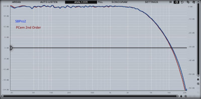

Sound Card Lowpass Filtering Measurement
To measure lowpass filtering of any sound card you can use Mpxplay for DOS (link, also attached) with the attached Test WAV package to play white noise and capture with spectrum analyzer.
You can also use Wolfenstein 3D rifle PCM sound (weapons 3 and 4) to compare lowpass filtering between sound cards.
Same for OPL3 lowpass, use Adlib Tracker 2 player called adt2play.exe to play the noise.a2m file and capture with spectrum analyzer.
Results should be similar to this:
* White noise PCM should be flat without filtering, so it's easy to see what LPF the sound card uses.
** SB Pro 2 (CT1600) is a simple 2nd order Butterworth at 3.2kHz.
