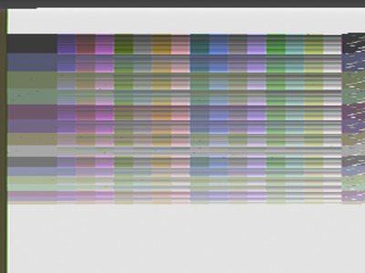

I took the liberty of modifying your program to enable the colorburst (portw(0x3D8) = 0x1A0F).
captured.png.raw.zip
Thanks - that seems to have worked wonderfully! I was half-expecting the palette register write to take too long and scribble on the leftmost block. This might still be a problem for the PCjr, but if so I can use an IRQ0 for timing.
I'm working on the calibration program now.

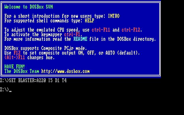

NewRisingSun wrote:
Patch for PCjr composite support, tested with […]
  • Ultima II (special PCjr version)
  • B.C.'s Quest for Tires
  • The Seven Cities of Gold
I edited this patch, added instruction in /src/shell/shell.cpp.

videogamer555 wrote:
Awesomd CGA composite effect! It doesn't work now though at all. It should also be possible to use in text mode. After all, the same glitches you see in a graphics mode, when running composite video, would (on real equipment) also apply in text modes. The reason for this is that in composite video, the color is set by a subcarrier, who's frequency is equivalent to very narrow brightness features (like white text on a black screen). So for this to be true to real hardware, the composite video effect should also work when using 80x25 and 40x25 text modes.
This was superceded by later patches where you can now use the function keys to control composite mode (see the screenshot above, F12 enables or disables composite mode whenever you want).
