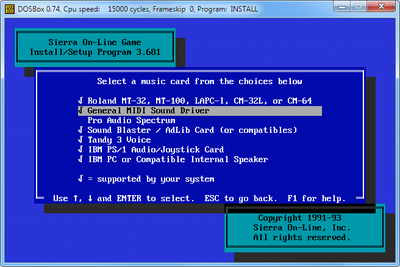

Hi @lukeman3000,
There's something odd in your video. I tried to reproduce this 'hanged note' problem in SCVA without success. But what's troubles me more is the SC MIDI channels that appear to receive the game's MIDI data shown in your video. It looks like they're route from the game to channels 10, 11, 12, 13, 14, 15 and 16 in SCVA. On my end the active channels at this Sierra intro are 4, 5, 6, 7, 8, 9 and 10.
Saw that you already solved the problem but just a thought, which MIDI driver did you pick from the game's setup: "Roland MT-32, MT-100, LAPC-I, CM-32L, or CM-64" or "General Midi Sound Driver"? The right one to pick when using GM sound module is the General Midi Sound Driver, and gladly Sierra included this driver with their latest games (see screenshot)
37.47 KiB
4321 views
If you pick MT-32 when using GM sound module you'd probably encounter wrong instrument mapping. This was the case with the incorrect sound when opening/closing the box in KQ6 that you posted on YouTube https://www.youtube.com/watch?v=hxqfqhtcno0. I'm not sure but it might be worth to check if this solves this problem as well.
