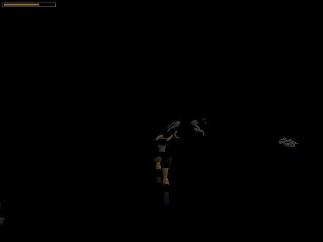

Hmm. I dont want to bring bad news but in TR1 there are not all textures with DGV 1.40bR2.
Here is a part of the Logfile:
Entering DosNTEntryPoint() in server
Server: waiting for a client to be servedgrSstWinopen:
required refresh rate: 60
grSstWinopen: InitDraw() OK
grSstWinopen: InitMovie() OK
grSstWinopen: lpD3D->CreateDevice() OK
Warning: startup: Paletted textures are not supported! Is it an nVidia card? If yes, why does not it support them??? Argh...
W-buffering: Relying on driver flags, true W-buffering CANNOT be used, using emulated W-buffering instead!

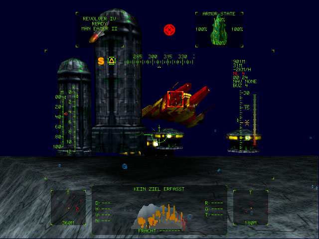

But I also have some good news. You said Archimedean Dynasty will not run with DGV in Win98 or WinXP. Here is a shot made on my GeForce3 PC with Win98 and DGV1.31 (newer versions reach not ingame but I don't know why). There are some depth-problems and something with the fog isn't right but it is playable. While loading the mission I had to change fast to the console and after start of the mission I had to change back to the server. Otherwise the game crashed. I will write down the DGV-settings soon for you.
Hmm, does only 1.40Br2 do it, or r1 too?
