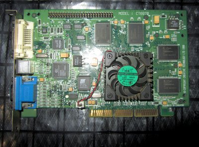

Reply 266 of 318, by rav85
hello,
i bought creative CT 6970 OEM card for IBM or other vendor, i'm looking original bios creative CT 6971 and bios edit program
Thank you for your help

Reply 268 of 318, by TheAbandonwareGuy
rav85 wrote:
hello,
Creative made Dell's boards too but there not branded like most of there OEM stuff is. You should be able to use the BIOs from one of those. I'd pull the BIOs off mine if I hadn't sold it when someone offered me 50 dollars for it.

Reply 276 of 318, by The Serpent Rider
Finally got 32mb variant of GeForce DDR. Creative Annihilator Pro with DVI no less. Now all I need to find is deluxe variant of ASUS V6600/6800 any my quest will be complete.
The attachment Creative Annihilator Pro.jpg is no longer available
