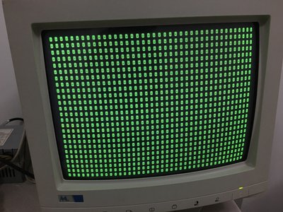

I recently bought some 486 hardware to start my retro PC project. But after several tries, cleaning, jumper settings check, voltage check with multimeter... I only get this:
462.85 KiB
2019 views
Some random colored characters shows up immediately after power on, then this screen freezes for a two seconds, then all goes black and a low tone long beep is heard from the speaker.
The specs are:
SIS 471 rev. B motherboard
Intel 486 DX4-100
2x 16mb 72 pin EDO RAM
Trident 9440 VLB
Does anyone have an idea of what's wrong? BIOS corrupted? Video BIOS corrupted? Too much or incorrect type of RAM?

Reply 3 of 19, by bakemono
I couldn't get EDO RAM to work with a SIS 471 board. Try moving the memory and video card to different slots, but I suspect you'll need different RAM.

Reply 5 of 19, by Tiido
EDO definitely doesn't work on a SiS471, only FPM does.

Reply 13 of 19, by Tiido
My SIS 471 board has an army of jumpers for setting RAM banks/size and they have to be set right for things to work right.

Reply 19 of 19, by diegotmc
Ok, updates:
These settings that I posted are different from my board. But yesterday I started playing with some jumpers and found that JP41 probably is the one that selects the memory banks in use.
And then the system started to come to life!!
But it was very unstable. Sometimes no image at all, sometimes it showed up the Trident logo, beeps, and stops in a screen only with the cursor blinking, and 2 times it showed the next screen identifying the CPU as a 75mhz with the text grayed, and locks up...
Today the FPM 72pin memory arrived... and now it's working!

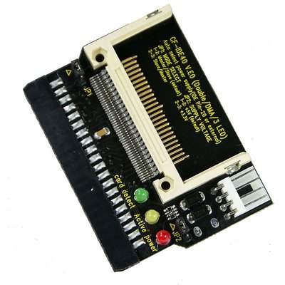

But the new problem is: I can't boot from the CF card. The system reboots everytime it tries to boot from the card.
I'm using a 512mb that is already prepared with MS-DOS 6.22 (i've tested it in my old laptop, and it's ok), and a cheap CF to IDE adapter like this one:
75.84 KiB
1321 views
It was identified normaly in the IDE HDD auto detection.
Any ideas what's happening?
