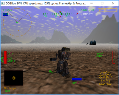

Not sure if you're still interested in this topic.
Mechwarrior 2 Merceneries Titanium edition running in DOSBox/Win98SE with 3Dfx acceleration on Windows 10.
I can also get Mechwarrior 2 original 3Dfx version to run as well within DOSBox.
No need to use MechVM.
System is AMD FX8300.

DOSBox SVN + Kekko 3Dfx patch + my own bigmem_384M patch and a disk image of Win98SE. Install Diamond Monster 3D drivers for 3Dfx voodoo1, and you are ready to go. DOSBox supports mounting 2 disk images. You can use the 2nd image mount to store the ripped games CD images. Use Daemon tools or MagicDisc to mount CD image during game play.
It is not very straight forward, but you can search the forum to gather all the details on how to do that. Unfortunately, the official DOSBox does not support running Win98.

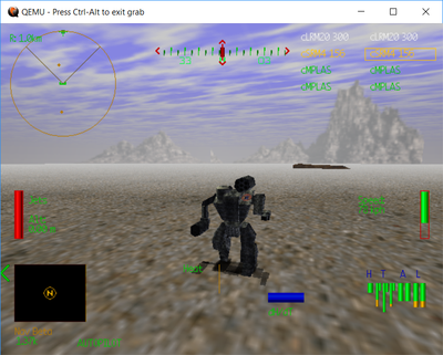

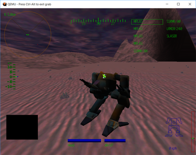

Native WIN64 QEMU with 3Dfx Glide pass-through in action, running Mechwarrior 2 31st 3Dfx enhanced version and Titanium Mechwarrior 2 Mercenaries, using dgVoodoo2 64-bit in Windows 10 Pro build 1803.
!!! 3Dfx Glide lives on !!!

Mind if I ask a few questions on specifics....
Are you running a Win10 x64 virtual machine on Linux?
How is the frame rate?
Any mouse or visual glitches?
Are you able to run MW2 in larger than the games native resolutions?
Are you able to use anti-aliasing?
Thanks for any feedback.

No. QEMU runs Win98SE as guest OS. Host can be Linux or Windows 10.
Without WHPX/KVM acceleration, 45~55-ish FPS, no targeting and no object in line of sight. FPS can drop in 10-ish range with targeting, particle trails and chunky explosion.
With WHPX/KVM acceleration, FPS will mostly stay at 60FPS or more, with occasional high 30-ish during intense action, 2 or more mechs in line of sight, explosions etc. Jump-jets recharge rate slowed at high 50FPS.
Mouse behaves as normal. It can be used for point targeting and firing. The visual aspects are mostly the job of the Glide wrappers. For dgVoodoo2, it is perfect, I would say. PsVoodoo gets the job done pretty well, too, nothing that I would complain. OpenGlide has issue with fogs, but can be worked around by disabling fog in OpenGlide.ini or keeping the realistic HUD all the time. Yes, you can scale the game native resolution (which is 640x480) to any 4:3 resolution. PsVoodoo can only do simple image stretching, so some stuffs will get zeggy unless you had forced anti-aliasing at the driver. DgVoodoo2 has more native controls on scaling including anti-aliasing. OpenGlide can only scale perfectly at exact integer ratio such as 1280x960, otherwise there are artifacts on the texts and lines on the HUD.
The above is for Titanium version because the game uses Glide2x 2.4, and that gives you 3 options of Glide wrappers to choose from. For Mech2 31st, since it is Glide 2.1.1, only dgVoodoo2 works. And, dgVoodoo2 only works natively in Windows 10.
