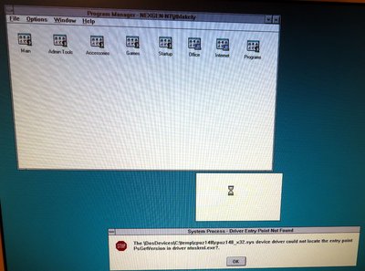

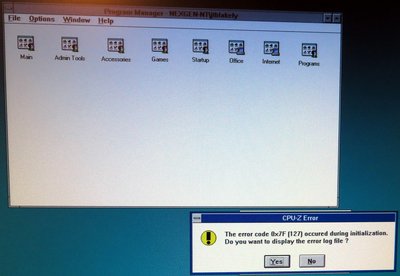

I ran the same CPUZ_w95 files on the NexGen with NT 3.51. Lots of errors.
The attachment NT35_1.jpg is no longer available
The attachment NT35_2.jpg is no longer available
The attachment cpuz_driver_72.log is no longer available
But it continued to run.
The attachment NT35_3.jpg is no longer available
The attachment NEXGEN-NT35.txt is no longer available

I updated to report more information on the Nx586, but only for Win95 atm. The NT driver includes a function that is not present in WinNT, and that prevents the driver from loading. I'll install NT to fix that issue.

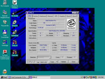

To do this download SIV 5.40 (http://rh-software.com/downloads/zip/siv_v5.40.zip) or later, run SIV32L.exe and send me the save file (Menu->File->Save Local). SIV32L.exe should work on both NT 3.51 and W95.

The missing function (PsGetVersion) does only concern NT 3.51, so it should work ok on NT 4.0 (unless another function is missing !)

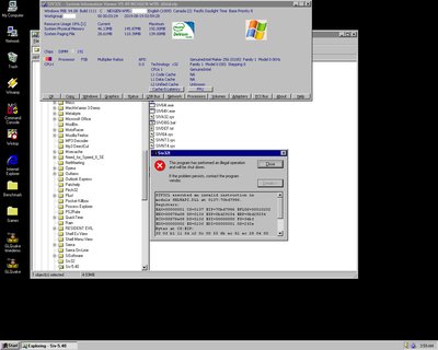

red-ray, does SIV32L also work on a 386, SXL2-66, or IBM BL3-75? Attached is the report for Windows 95c. SIV32L also required me to run IDON.COM.

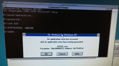

SIV32L will not run on NT 3.51 with the NexGen. See attachment below.
The attachment SIV32L-NexGen-NT35.png is no longer available

Thank you and I suspect the reason you need to run IDON.COM is down to what SHLWAPI.dll does. I am unsure about how to address this and will have a ponder.
SIV made a valiant attempt, but W95 reported the CPU as a 386 which confused SIV. I have made some adjustments and the attached should do rather better, does it?
It's possible the reported speed may be incorrect as I am unsure how many cycles AAM takes so I guessed @ 15, what does Menu->Help->Conversions->CPU MHz report? Once I see this I will be able to fix things.

I started answering before you edited the post. I am wondering how far it gets, please do SIV32L -DBGINI which should generate SIV_DBGOUT.log. Is there a Dr Watson log file I can get?
Any SIV32L.exe should work on both W9x + NT 3.51 and later, it even works on my W10 x64 system, but only reports 32 of the 32 CPUs.

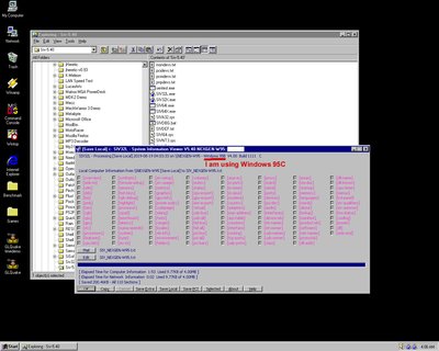

Reply 32 of 465, by feipoa
Alright, let me check that NT 3.51 startup flag. NT3.51 doesn't have the IDON.COM program to do its thing, but I also tried using Alternate Instructions in the BIOS, but SIV32L still did not work with NT 3.51/NexGen.
Here is the speed report you asked for from Win95c/NexGen
The attachment NexGen-W95-Speed.JPG is no longer available

For NT 3.51:
SIV_DBGOUT.log was not generated in the SIV folder. I'm using the original version you posted, not the beta for NT.
The attachment SIV32L-DVGINI.jpg is no longer available
Log from the Event Viewer is attached.
The attachment Event_Log_NexGen-NT35.txt is no longer available
