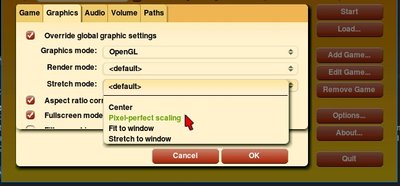

lukeman3000 wrote:
Please don't stop. Your patch is one of the main reasons I continue to use DOSBox over ScummVM (btw, does ScummVM have anything similar to the pixel perfect patch at this point, or is the PAR still messed up when playing games with ScummVM?)
ScummVM has added pixel-perfect mode (in daily builds) a year ago, i guess. Works as intended.
Please, post several ScummVM screenshots of different sizes taken in pixel-perfect mode. I will tell you the algorithm.

Ant_222 wrote:
I think its just integer scaler with added black borders (if needed)

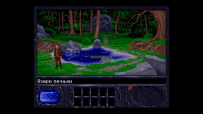

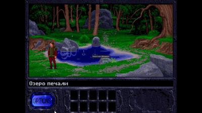

@ant_222, here you go, btw, screenshots from latest ScummVM build (aspect correction on, 1080p)
Bad news: both the screenshots use nearest-neighbor interpolation and have irregular pixel magnification, which means that the ScummVM developers not only have failed to implement pixel-perfect scaling, but also are deceiving their users by calling nearest-neighbor interpolation to the correct aspect ratio "pixel-perfect":
320x200 --[4.0x4.8]--> 1280x960
—only the horizontal scale is integral, whereas the vertical one is a fractional. It makes no sense.
Edit: To clarify—the rows in the "pixel-perfect" screenshot are magnified with alternating scales of 4 and 5 in a ratio of 1 to 4: 4, 5, 5, 5, 5, 4, 5, 5, 5, 5, ... yielding an average vertical scale of 24/5, or 4.8.
