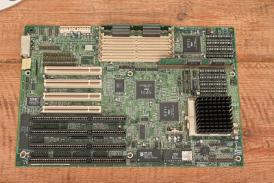

Reply 23 of 42, by mpe
As for the L2 - I am testing all combinations - 256kB / 512kB / 1024 kB async as well as 256kB and 512kB PB COAST modules. PCI VGA and EDO RAM. Configuration options are sparse on this board. Here is the full board:
688.53 KiB
1637 views
I had another Opti Viper board which worked fine although that one used a newer version of OPTi Viper and did not have any async SRAMs sockets - just the CELP slot
I suspect this could be some BIOS issue. Also investigation chipset register if I can tweak it a bit as usual utilities don't work. Will have to spent some time on this one. So I guess the results could change a bit.

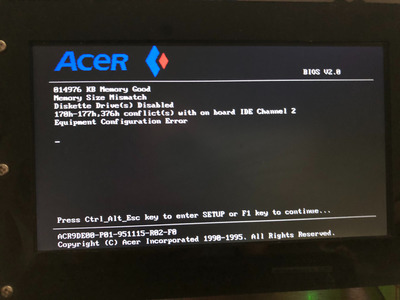

No. But perhaps it can be established from the POST string:
1.33 MiB
1632 views
Blog|NexGen 586|S4
Reply 26 of 42, by Anonymous Coward
Acer AN5C

Reply 27 of 42, by mpe
Thanks at least I know what it is. I could find any useful stuff about the board (BIOS, manual).
However, I found datasheet for the chipset with register info. So perhaps I can write a tool to compensate lack of BIOS options with some programming...
Blog|NexGen 586|S4
Reply 28 of 42, by Anonymous Coward
I have a feeling you will probably find the manual one day. Judging by the connectors on it, it looks to have come out of an OEM system (probably at least Acer, maybe Ambra, Fujitsu and others)...so whatever documentation or BIOS you find will be the OEM version. Since your splash screen says Acer, I would put my money on the AcerPower series, but maybe Altos.

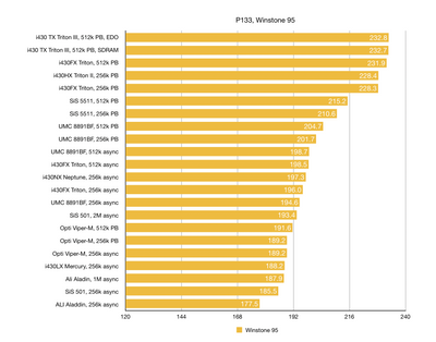

I've added two more chipsets to my survey.
  • SiS 5511
  • Intel 430TX (with both SDRAM, EDO)
Obviously the 430TX has taken the crown. However, the SiS5511 while not eaten into top-tier showed some good performance.

Reply 37 of 42, by bofh.fromhell
mpe wrote on 2021-03-28, 11:06:
I finally got a motherboard with VIA Apollo Master Plus chipset - FIC PA-2000 and updated the article. […]
It looks like the VIA took the crown for the slowest Pentium Socket 4/5/7 chipset I tested. But I am sure there are even slower chipsets, just need to find them 😀
With 25fps in Quake we are slowly getting into 486 territory. And that's with Pentium 133!
Nice chart!
Looks to me that HX with 512kB L2 would take the performance crown.
Well atleast in Quake.
