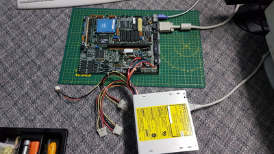

Hello,
I have a Packard Bell 486sx. The motherboard is marked PCB4100 rev B.0.
344.48 KiB
2402 views
When I got the computer the barrel battery had leaked. I removed the battery and replaced it with a CR2032 using the external battery connector. I also cleaned the board and replaced a nearby chip (F151A) that had succumbed to corrosion.
77.91 KiB
2402 views
The computer POSTs and seems fine. I mention all this just to provide some history.
I am attempting to use a Compact Flash to IDE adapter in place of a typical hard drive but am running into an issue. It seems that when reading/writing from/to the card everything is really slow. The CF card(s) I have tried, all under 512MB, have been set up in the BIOS (Phoenix V1.00) with their correct CYL/HDS/SEC as detected by WHATIDE.COM and are recognized. I can delete/create partitions using FDISK.EXE and format using FORMAT.COM from DOS 6.22 without issue.
When I run a surface scan using SCANDISK.EXE I get a visual representation of the slow behavior. Scandisk will scan for a second or so, hang for a couple seconds, scan another 100+/- clusters, hang again, scan some more and so on.
Loading WFW 3.11 takes about 5 minutes but eventually will load. There is also a delay starting any additonal programs while in Windows. Even EDIT.COM takes a 10 count to load from the C:\ prompt.
I have tried 3 different CF adapters with multiple cards and all behave the same.
However, When I use an actual hard drive (Quantum ELS127A) the computer runs fine and there is no delay issues. Can anybody give me a clue as to why the compact flash adapters are not working in this computer? I have used these adapters in other computers (PII's) without issue.

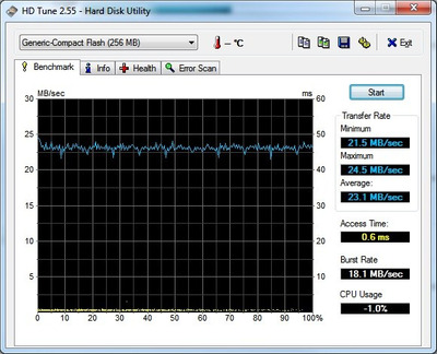

A test of the CF card in Windows 7 using HD Tune 2.55 produced these results...
Transfer Rate Minimum : 21.5 MB/sec
Transfer Rate Maximum : 24.5 MB/sec
Transfer Rate Average : 23.1 MB/sec
Access Time : 0.6 ms
Burst Rate : 18.1 MB/sec
CPU Usage : -1.0%

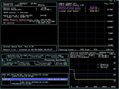

A test of the CF card in the 486 using SpeedSys...
Tested in FULL mode
Random access time : 0.45 ms
Linear verify speed : 15353 KB/s
Min/Max verify speed : 15286 KB/s / 15383 KB/s
Linear read speed : 2286 KB/s
Min/Max read speed : 2286 KB/s / 2287 KB/s
Buffered read speed : 2324 KB/s
Hard Drive speed index : 1128.63
79.88 KiB
2309 views
Not sure how to enable/disable shadowing. Is this in the BIOS? I see no mention of it. There are not a lot of options to choose from.

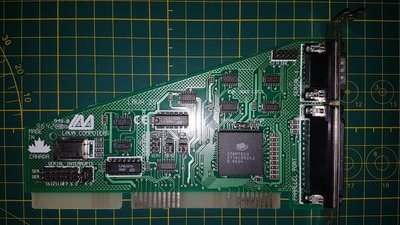

There is a riser card from the the board. It has 4 ISA slots. One is occupied by a Lava Computers 2 serial port card.

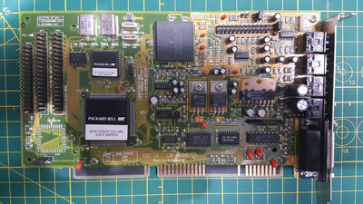

Another has an Aztez sound card, FCC # I38-MMSN811.
280.62 KiB
2301 views
The sound card works fine. I haven't tried the serial port card and considered removing it but since this is the way the computer came to me I haven't yet done so.
I don't have an ISA IO card to try??? (as I google what one is)

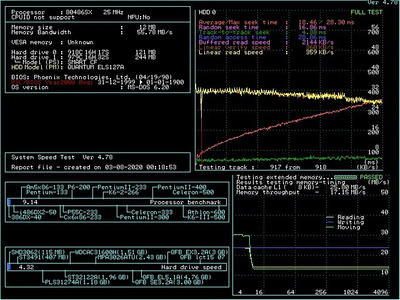

Reply 15 of 33, by stuartmcivor
BushLin wrote on 2020-08-03, 20:55:
Have you run the computer with a regular IDE drive? (Same OS, config and drivers)
Yes. When I use a regular IDE drive it is faster.

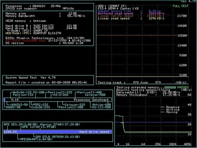

Here is the output from SPEEDSYS.EXE running on the 486 with a regular HDD as IDE0 Master and the CF as IDEo Slave...
ÄÄÄÄÄÄÄÄÄÄÄÄÄÄÄÄÄÄÄÄÄÄÄÄÄÄÄÄÄÄÄÄÄÄÄÄÄÄÄÄÄÄÄÄÄÄÄÄÄÄÄÄÄÄÄÄÄÄÄÄÄÄÄÄÄÄÄÄÄÄÄÄÄÄÄ
System Speed Test Ver 4.78 Report file - created on 03-08-2020 00:25:46
CPU is in V86 mode: No
Processor : ï=(r) 80486SX 25 MHz
CPU speed index : 9.14
Total memory size : 12 MB
Memory Bandwidth : 55.78 MB/s
VESA video memory : Unknown
Hard drive 0 : 918C 16H 17S 121 MB
Tested in FULL mode
Average/Max seek time : 18.46 ms / 28.30 ms
Random seek time : 16.86 ms
Track-to-track seek : 4.38 ms
Random access time : 28.86 ms
Linear verify speed : 360 KB/s
Min/Max verify speed : 188 KB/s / 413 KB/s
Linear read speed : 359 KB/s
Min/Max read speed : 249 KB/s / 411 KB/s
Buffered read speed : 2144 KB/s
Hard Drive speed index : 4.32
Hard drive 1 : 979C 16H 32S 244 MB
ÀÄÄÄÄÄ Model (PS): SMART CF
Tested in FULL mode
Random access time : 0.44 ms
Linear verify speed : 15414 KB/s
Min/Max verify speed : 15374 KB/s / 15442 KB/s
Linear read speed : 2296 KB/s
Min/Max read speed : 2296 KB/s / 2297 KB/s
Buffered read speed : 2333 KB/s
Hard Drive speed index : 1245.53
BIOS vendor : Phoenix Technologies, Ltd. (04/19/90)
Year2000 Bug : 31-12-1999 01-01-1900
OS version : MS-DOS 6.20

and a pretty graph for the HDD...
92.17 KiB

and for the CF...
82.2 KiB
2205 views
Reply 16 of 33, by BushLin
I don't see a benchmark metric where the compact flash card isn't many times faster (although they're all read tests)
Screw period correct; I wanted a faster system back then. I choose no dropped frames, super fast loading, fully compatible and quiet operation.
