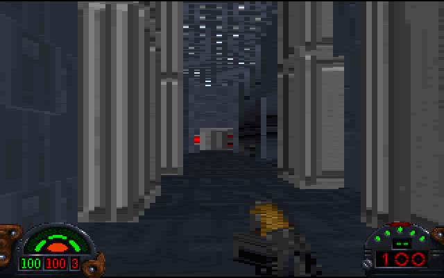

Maybe Fastdoom could have the old scrapped "2MB RAM support" idea of loading only 3 generic sounds commonly applied to everything (Gun fire, Death OOGH, Door swish), as seen in the Nov 93 "A visit to id software" video
For all those potato fans (and haters that don't get the point), a reminder that Dark Forces had such a mode

leileilol wrote on 2020-08-07, 00:23:
I had no clue Dark Forces had a "potato mode". Is this achieved by lowering the detail within the game or is this some sort of command line switch? I don't remember the in-game options lowering the details that much!
Reply 53 of 987, by Oetker
Garrett W wrote on 2020-08-10, 12:20:
Yes you can limit the in-game detail to Atari 2600 level.

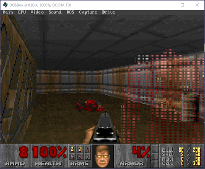

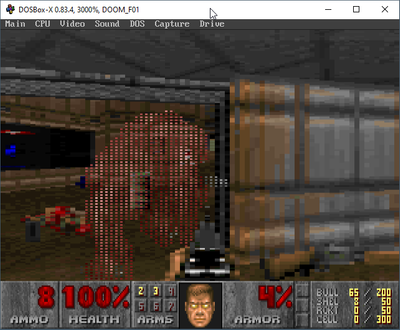

  • Faster Potato mode. Now it's 100% native potato mode and doesn't use the LQ mode to draw the screen.
  • Fixed Sega Saturn shadows in potato mode.

Reply 58 of 987, by ViTi95
HandOfFate wrote on 2020-08-13, 16:41:
Cool, I'll be sure to try it out (once my computer room is below Hell temperatures). I'm curious to see if the FPS has improved even more, compared to my earlier benchmarks.
What do you mean with Sega Saturn shadows? Was there something bad about the shadows in the that port?
The implementation I made of the Sega Saturn shadows in FastDoom wasn't right while potato mode activated. The rendering was just wrong.
