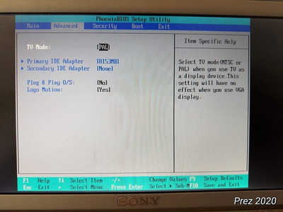

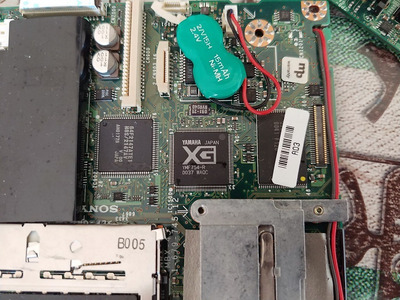

It seems i'm running into the same problems with a Yamaha YMF754 inside this time a very small and cute Sony PCG-C1VE.
I tried everything we said or experimented before on this post Problems with a YMF754 inside a Toshiba Tecra 8200 but nothing works good this time.
The soundchip is a YMF754-R :
227.99 KiB
1026 views
In the BIOS, there is nothing about changing IRQ of the YMF :

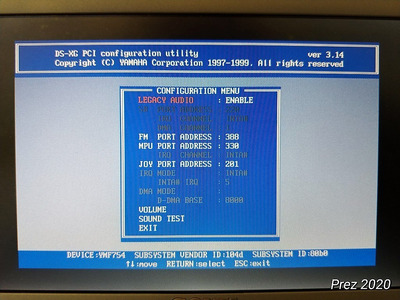

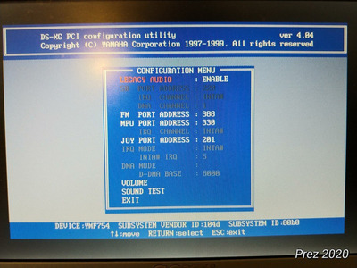

Under DOS, if i use the SETUPDS modified for ICH2, or any SETUPDS i have for different southbridges, i have the same result exactly :
255.97 KiB
1025 views

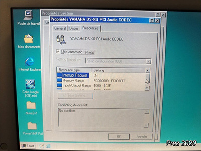

The YMF754 is using by default IRQ9 :
224.9 KiB
1025 views

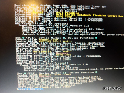

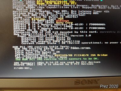

The southbridge seems to be an Intel PIIX4E/M :
229.91 KiB
1025 views
Any idea what drivers or setupds i should use please ?

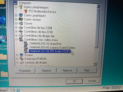

Reply 1 of 17, by Prez

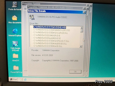

Under Windows 98SE, i used some default VDM drivers and it sounded great. Still, i tried these VXD drivers but the sound doesn't works, just a strange noise on the left speaker :
264.18 KiB
1022 views
149.25 KiB
1022 views
228.67 KiB
1022 views
I'm a bit lost. Is there a VXD drivers working with a YMF754 ?

Hi all,
I will try the drivers i found on this other thread :
No sound using Yamaha YMF744/754 VXD drivers under Windows 98SE (Sony PCG-C1XN) (SOLVED !)
Still, under DOS mode it will not be working. I may look on the YMF7x4 thread on Vogons about modifying a SETUPDS.EXE to make it works with my chipset 😒

Did you tried to manually change the IRQ to 5 in Windows?

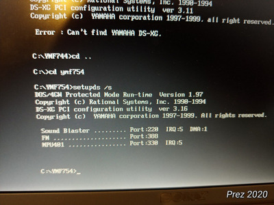

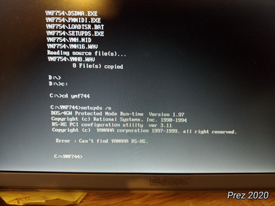

Reply 12 of 17, by Prez
MAZter wrote on 2020-11-26, 17:52:
Try any drivers from archive, maybe at least one work with your laptop: […]
https://drive.google.com/file/d/1Hcm5R0TB1ikz … iew?usp=sharing
Before change any parameters, try to just start for Dos with existed to initialize card:
setup.exe /s
if it's not work, than change parameters. Both Dos versions work with any my YMF744-YMF754 laptops

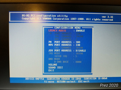

Hi !
No luck with these.
YMF744 setupds won't recognize the soundcard at all :
149.49 KiB
863 views

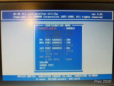

YMF754 will and when i launch setupds /s i have this :
155.88 KiB
863 views
Inside setupds.exe i have no choices in fact :

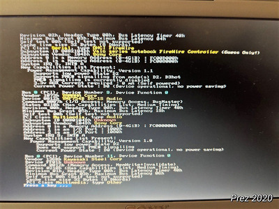

225.11 KiB
863 views
For remembering, what tells me PCI :
252.23 KiB
863 views
Best regards
Philippe Dubois
Old computers and videogames freak
President of french association https://mo5.com
Get better, get old ! 😁
Reply 13 of 17, by Prez
Kamerat wrote on 2020-11-23, 21:04:
As for DOS usage I don't really know if the integrated northbridge of the Transmeta Crusoe are capable to do DDMA. Can you give us the full output from PCI.EXE to see which PCI IDs it uses?
Hi !

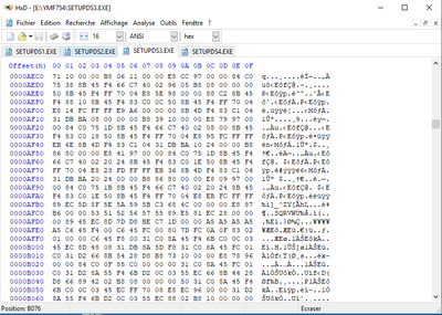

I did modify to test severval versions of setupds.exe program, version 3.16, to match the PCI ID of the ISA bridge (Intel) or the northbridge (Transmeta).
I followed this thread :
Yamaha YMF7x4 Guide
and this post:
"Modified the SETUPDS utility so I'm now able to use DDMA mode on a VIA KT133E/686B platform. Used the version on Yamaha's site and modified offset AEC0 and AEC1 from 96 05 to 86 06 (the PCI ID of the "PCI-to-ISA bridge").
Nice guide BTW. 😀"
With these values :
Bus 0 (PCI), Device Number 0, Device Function 0
Vendor 1279h Transmeta Corp
Device 0395h LongRun Northbridge
Command 0006h (Memory Access, BusMaster)
Status 2200h (Received Master Abort, Medium Timing)
Revision 00h, Header Type 80h, Bus Latency Timer 00h
Self test 00h (Self test not supported)
PCI Class Bridge, type PCI to HOST
Subsystem ID 02951279h Unknown
Subsystem Vendor 1279h Transmeta Corp
Address 0 is a Memory Address (0-4GiB) : FC100000h
Bus 0 (PCI), Device Number 7, Device Function 0
Vendor 8086h Intel Corporation
Device 7110h 82371EB/MB PIIX4E/M ISA Bridge
Command 000Fh (I/O Access, Memory Access, BusMaster, Special Cycles)
Status 0280h (Supports Back-To-Back Trans., Medium Timing)
Revision 02h, Header Type 80h, Bus Latency Timer 00h
PCI Class Bridge, type PCI to ISA
But nothing changed, nothing worked as expected 🙁 any clues ?

Reply 14 of 17, by cyclone3d
Screenshots of what you are getting inside setupds now that you have a modded one that works with your card?
Yamaha XG repository
YMF7x4 Guide
Aopen AW744L II SB-LINK
Reply 15 of 17, by Prez
cyclone3d wrote on 2020-12-04, 16:58:
Will do !
But everything is grayed out 🙁

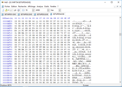

Here is a link to my modified setupds.exe files, 4 of them, if you wish to have a look (with the DS.INI file i used) :
http://jegeek.net/telechargements/drivers/sou … 54_SonyC1VE.zip

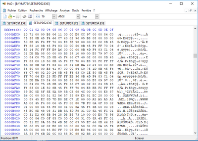

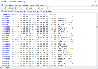

Two of them are modified to match the Intel ISA to PCI bridge ID, with a swap between bytes :
and the two others ones are modified to match the Transmeta northbridge PCI id :
Here are the modifications done :
64.58 KiB
718 views
64.29 KiB
718 views
64.59 KiB
718 views
64.28 KiB
718 views
I renamed them 4.0x to be sure to use the modified ones.
Results are following :
Best regards
Philippe Dubois

Reply 17 of 17, by Prez
Results are :

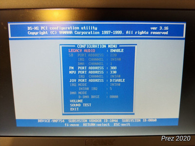

The original 3.16 i used give this :
223.58 KiB
716 views
The Setupds1.exe gives this :

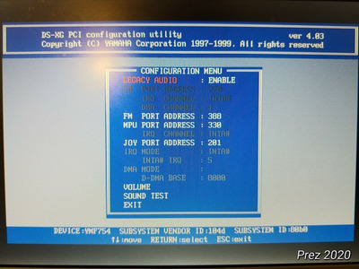

The Setupds3.exe gives this :
268.62 KiB
716 views

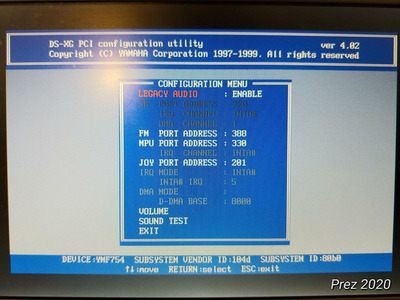

The Setupds4.exe gives this :
261.2 KiB
716 views
As you can see, nothing works 🙁
Maybe i did something wrong with the modified setupds.exe files ?
