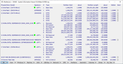

Reply 21 of 49, by red-ray
darry wrote on 2020-11-24, 23:05:
That could definitely be the case. My FC1307A adapters identify as FC1307 in their BIOS . Another possibility is that there are […]
red-ray wrote on 2020-11-24, 20:45:
My controller uses an FC1307A and having the first partition as FAT-16 is fine, maybe this is down to it being the A […]
darry wrote on 2020-11-24, 20:12:
make sure that the first partition on the card is FAT32 or NTFS, otherwise you will almost certainly have issues. That first partition does not need to be big or usable by DOS,or even set to active . If the first partition is FAT12 or FAT16, all the FC1307 based adapters that I have tested will see the disk as blank on power up .
I have Windows 98SE installed on the first partition and WXP + W2003 on the NTFS partitions
file.php?id=96945
That could definitely be the case. My FC1307A adapters identify as FC1307 in their BIOS . Another possibility is that there are multiple BIOS versions circulating for these and not all of them have the issue .
If anybody can post a BIOS dump from an FC1307 or FC1307A that does not have an issue with a FAT16 or FAT32 partition being first on the disk, it might help explain why some people, like jmarsh and myself, have the issue, but others do not .
EDIT: Are those all partitions on an MBR disk or are some of them volumes in an extended partition ?
What revision does your card report itself as being? Mine reports as Rev 1.2.
All but the first are volumes in an extended partition, given I have 98SE on the system then this is the sensible way to setup the disk.
As I recall I used MS-DOS 6.22 to create the first partition, installed 98SE into that, used 98SE to create the extended partition + other FAT-16 partitions, finally created the two NTFS partitions as I installed WXP with Windows 2003 being the last software I installed.
file.php?id=96968

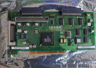

thank you so far for advice and comments
i did cross my mind to keep the old seagate drive for the sounds and slight nostalgia and use a cf/sd/scsi card/adapter for performance increase on games where this build meets the requirements no issues but doesn't preform well as i said pure dos is ok (so far) but in windows 3.11, some don't, despite meet well above min system requirements
i am also looking for faster cd-rom drive (from the double speed one that came with this system) that would still fit the era-ish of machine (4x speed min, 8x speed recommended and 16x speed max)
seems cf card might the most easy way to use sounds like a performance increase over a the seagate 3000rpm hdd
if i did go down the scsi route, since i do have pci scsi card - i am guessing i will need edit a dos setup disk with scsi drivers in there config.sys and autoexec.bat for dos 6.22 setup to see the drive and format and install etc

I have a rev 1.3 in a micro SD to CF adapter , a rev 1.4 in a microSD to 2.5" IDE adapter and a rev 1.2 in a microSD to 3.5" IDE adapter . I just realized that I have versions other than 1.2 (which I dumped and is identical to the one here https://goughlui.com/2019/02/03/tested-generi … dapter-sd35vc0/ ). They all have the same "disappearing partition" issue if a FAT12 or FAT16 primary partition created by either Windows 10 disk management console or my Roland VS-880EX is the first partition on the disk .
Creating and formatting the same type of partition either with Easus Partition Master 11.9 or CentOS 7 fdisk and mkfs.vfat -F 16 works fine with the FC1307A .
Some more details here : Re: Using a vintage multi-track recorder as a mixer, namely the Roland VS-880EX - might apply to other Roland VS- units
I just checked what happens when I create a FAT-16 partition on Windows as compared to MS-DOS 6.22 and feel this explains things.
Basically FAT-16 is ambiguous and looking in winioctl.h there are three different types of FAT-16 partition and which you get depends on the size of the partition and which OS you use.
#define PARTITION_FAT_16                0x04      // 16-bit FAT entries
#define PARTITION_HUGE 0x06 // Huge partition MS-DOS V4
#define PARTITION_XINT13 0x0E // Win95 partition using extended int13 services
With MS-DOS 6.22 you get PARTITION_FAT_16 or PARTITION_HUGE and with Windows 10 x64 Enterprise V10.00 Build 19042 20H2 you get PARTITION_XINT13. From what you said I suspect it's the XINT13 one that causes the issue, do you now also think this please?
Now I know XINT13 is FAT-16 I will get SIV to report FAT-16 Xint13.
file.php?id=97037

i do like the sound the old hdd make during boot up and maybe thinking of keeping the seagate drive in and using a cf card/scsi card for games as a slave
would putting windows on the d drive help with performance or maybe put the windows swap file on the d drive
it a LSI logic symbios sym21002
i think it has it own bios as it appears as ncr-pci something during post but when i put in dos 6.22 setup floppy it doesn't see anything
but manage to find drivers that work in dos and has to use a later version of aspi manager driver for the card to work with and see anything connected to it, so i made me think that i need to install the drivers in dos first for a scsi drive to work

I'm sorry if this is obvious but DOS setup won't see anything if you have the controller installed but no drive attached. If you connect a SCSI HDD the controller's bios should handle it

Sorry yes you are 100% correct and I am wrong re the scsi card. I'm just too used to old adaptec cards and the like, I tend to forget about these new aspi based cards

ok so if went down the scsi route - an old adaptec card would work out the box and would i t matter if it was isa of pci and would any adaptec card work or only certain ones without needing to install drivers first
i was thinking if did go for cf /sd/scsi and would that be "faster" than the old seagate drive but keep the seagate as a boot drive (until its time comes and start to fail) and put the swap file of the "faster" drive

I have that same LSI card, it does work to boot DOS without drivers. Your card's BIOS may be disabled.
Another possibility: the card may not install its own BIOS int 13 routines if you have the main system BIOS setup with an IDE hard disk. If you try to boot from a floppy with *only* a SCSI disk connected it should appear as drive C:
