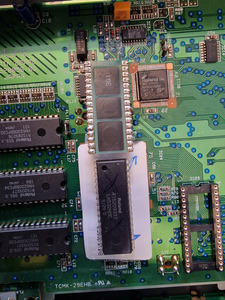

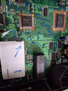

Reply 27 of 38, by Karmeck
keropi wrote on 2024-06-25, 06:23:
Karmeck wrote on 2024-06-25, 05:17:
Would this one suffice?
https://www.tradera.com/item/408322222
What is that "70" at the end of the name?
yes it will be perfect
-70 is the speed rating in ns - it is a faster eeprom than needed so no issues there
So, this was a little big. The seller tells me to bend the legs? Is this a tested method?
Reply 28 of 38, by keropi
Karmeck wrote on 2024-09-17, 12:56:
which is the original chip? the one with the 3 blobs? that looks like a combo chip used for something else...
🎵 🎧 MK1869, PCMIDI MPU , OrpheusII , Action Rewind , Megacard and 🎶GoldLib soundcard website
Reply 29 of 38, by Karmeck
keropi wrote on 2024-09-17, 13:31:
That is somthing els. The shop took the wrong chip. That is a chip from them scc-1A.
Reply 30 of 38, by Karmeck
All is well
