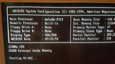

Right. I did a makeshift repair of my old test leads... I got impatient. I found that R17 on the CPU socket (where DX4 and Am5x86 are supposed to receive signal for CLKMUL) goes to JP30 pin 2 and JP32 pin 1.
The board boots with Intel DX4 settings using my Am5x86, no problem, but Chkcpu claims that L1 cache is enabled in Write-Through mode. It's set to Write-Back in BIOS.
I've found a few good sites today though, so I'm feeling more confident that I can get both WB L1 cache and 4x multiplier working soon.

Reply 32 of 37, by mkarcher
LunarG wrote on 2021-04-24, 15:23:
The AMD and Intel DX4 / 5x86 processors do not support software-selectable L1 mode. The BIOS setting is only effective on Cyrix 486 / 5x86 CPUs. You need to find a jumper that sets the cache mode to get the DX4 / 5x86 into L1 WB. Of course , this only works if the board supports L1WB on (enhanced) Intel DX4 / Am5x86 / low-voltage Cyrix 486/5x86 processors at all. (it's the same bus protocol on those processors, but it is different on classic Cyrix processors and the PODP).

Reply 34 of 37, by LunarG
Partial success! 😁
Got the multiplier working. Running Intel DX4 settings at the moment. As soon as I got the multiplier set, it reported as the correct CPU in POST, rather than 486DX4-Plus.
So next goal is to get WB L1 cache. 😀

Reply 35 of 37, by TheMobRules
Nice! L1 WB may be a bit trickier, since it involves connecting several lines between the CPU and chipset, so that may require more than one jumper depending on how the motherboard was designed.
This page is a good resource if you want to figure out the correct jumper(s) for L1 WB in a 5x86 among other things.
