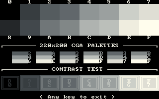

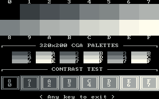

Reply 27 of 34, by basic
I fixed this patch, it will patch correctly with DOSBox SVN r4019.
And added paper-white color in CGA/Hercules mode, press F11 to cycle through green, amber, RGB-white, and paper-white.
cga_mono_r4019.diff
10.01 KiB
237 downloads
Thanks, VileRancour.
Paper-white palette looks like actual white monochrome monitor.

Reply 28 of 34, by VileR
Interesting, how did you derive the paper-white gradient?
The color values look like the 16 steps are tinted (in various directions) away from grey... and according to the 'Paper-White Phosphors' sidebar here, that may actually have some basis in how these monitors are designed. Didn't know that. 😀
