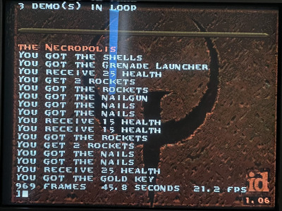

Apologies for the spam of posts, it was a long battle but finally I was able to duplicate pshipkov’s Quake score of 21.2 on the m919 @180MHz and 1024k cache.
Cache Speed = 2-1-2
DRAM Read = 1ws
DRAM Write = 0ws
L2 Cache = WT
*unsure if these settings are stable or the same that pshipkov used
This mobo is a pain, the memory I was originally testing with no longer posts, explain that 🤣. Currently using a 50ns EDO 16MB Samsung module. And EDO appears to be key to achieving the higher memory througput.
Shouldn’t my Doom score be higher? Is this due to the pci bus speed being cut in half? What’s the process to boot with PCI at full speed?
Also notice the Voodoo4 working on this mobo. I don’t think it or a voodoo 3 worked on the other UMC socket 3 boards I have.
Reply 1230 of 2513, by pshipkov
No worries about the multiple posts.
Good to see things working !
This configuration very stable here.
Automatic bus divider is tricked into not kicking in by booting with TURBO turned-off.
There seems to be non-cached memory address somewhere between 32-48Mb. Feipoa confirmed it as well. I stay below that range for best perf.
Same BIOS settings here - everything on max except DRAM READ and L2 cache in WT mode.
Very interesting that you got Voodoo4 working on this chipset.
Voodoo3 certainly didn't work on the 2 M919 boards here. Can you confirm that on your side please ? Just in case.

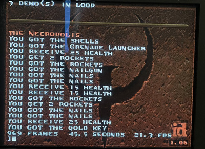

feipoa, this m919 board appears to favor Samsung EDO modules. I swapped the 16MB module for a 32MB 60ns EDO module and it appears to work just as well. Actually going from 16 to 32 has bumped my Quake score up to a consistent 21.3, how does that work?
The attachment 23B45F89-EA0C-4FD0-95D6-4546EDA33EA5.jpeg is no longer available
I’ve not tried the Voodoo3 yet, I need to pull it from another machine or find a 2nd for testing.

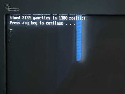

I don’t think the turbo trick is working for me as my Doom scores are still not great. I’ll try the switch on the FSB jumpers.
Edit: Booting at 33mhz with all three FSB jumpers in place then removing 1-2 and 5-6 after boot netted me a Doom score of 1033 realtics, much better. Is there a way to do it with only needing to change one jumper?
Checking my notes this m919 at 60x3 and 1024k cache is very close to the UUD at 50x4 and 256k cache. Although the UUD is by far the better board as feipoa has established. Still it’s fun to play around with this MEGACACHE! “Horns blaring”
