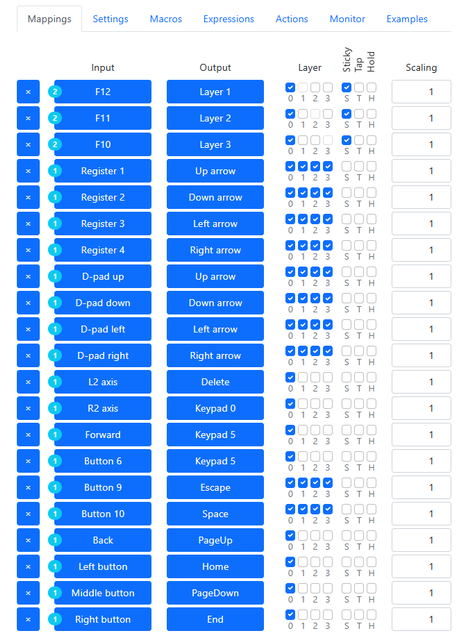

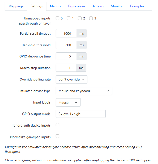

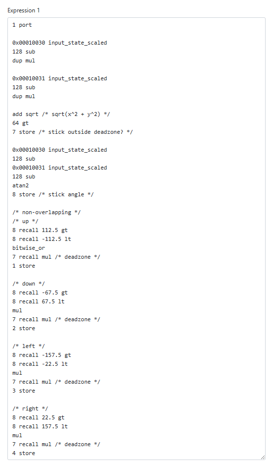

If you are just looking for HID gamepad to HID keyboard and/or mouse, you could hook a HID Remapper in front of the HIDman. No idea if both devices work together smoothly, I could test it if there is interest.
Interested that you test it.
Can you test on Batman Forever (DOS Version) ? (Not the Arcade one, the 2D style like Mortal Kombat).
This game have hardcoded controls using numpad only, who is a pain to play using the keyboard (it's litterally unplayable to do movesets)
And sadly as the USB controller is not remappable i can't use it either.There is others games who have weird hardcoded controls under DOS with same problems.
