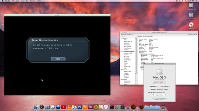

Today I slotted a "new" Quadro FX 4500 in Super G5 and did some benchmarking with Quake 3, Quake 4, Doom 3, UT2004, and Prey.
Here's the Doom 3 result. Keep in mind that, unlike the PC version, Doom3 for Mac only uses a single core. Plus, it's one of the worst ports ever. Aspyr didn't even *try* to optimize this game for PowerPC. To get an idea of just how sloppy it is, consider this: Quake 4 actually runs at a higher frame rate on this machine!
PowerMac G5 Quad: 2x dual-core PowerPC 970MPs at 2.5GHz, 16 GB DDR2-533, Quadro FX 4500 PCIe, OS X 10.5.8
1024x768 Ultra:
The attachment Picture 1.png is no longer available
The G5 is nearly three times faster than the G4, which at 1.5GHz w/ a 7800GS AGP, only manages 27 fps!

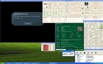

Reply 647 of 662, by agent_x007
Perfect score 😁
file.php?id=179424&mode=view
^NV build-in audio (since MB one doesn't have drivers for XP)
EDIT : 666.5, agent_x007, 5800X3D@4.55 GHz, Gigabyte B550 Aorus Pro v2, 32GB DDR4 3800MHz CAS 14, ASUS GTX Titan X 368.81, NvIdia (build-in audio), XPx86 SP3, Doom 3 v1.0

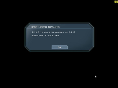

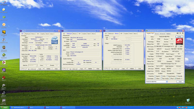

Reply 657 of 662, by Symbiotic_Kernel
Pentium 4 2.4GHz (Northwood) @ 3.03GHz (168x18), ABIT BH7, 1GB DDR420 2.5-3-3-7, Radeon 9800 (400/580), Audigy 2 ZS, XP-SP3
1024x768 Ultra - 33,6 FPS

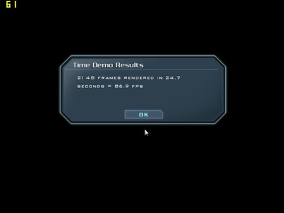

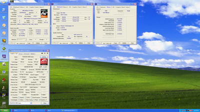

Reply 658 of 662, by Symbiotic_Kernel
Athlon 64 3200+ @ 2.32GHz (232x10), MSI K8N NEO, 1GB DDR 464 2.5-4-4-8, Radeon X850XT (CATALYST 10.2), X-FI, XP-SP3
1024X768 Ultra - 86,9FPS
