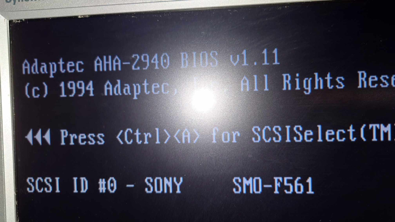

I picked up a Sony SMO F-561 drive capable of reading all big MO disks up to 9,1 GB in capacity and installed it today. Had previously bought an ADAPTEC AHA-2940 SCSI controller for PCI and a 50-pin tape in anticipation for getting this drive.
The drive does work mechanically - it does accept and return disks, the LED lights up in orange and green like it should and an I: drive appears in the system when a disk is accepted. However, I'm unable to open the drive's folder, I get the same error message as if there was no disk inserted (trying to open an empty drive), or earlier I was getting a message about some hardware error, luckily that one stopped coming. Anyhow, I do suspect this may have something to do with the SCSI adapter, since the MO drive was sold as new - paid an arm and a leg for it too, not to mention the Sony and Plasmon media disks I had to also get for it.
The drive is recognized in #0 position, which I'm not sure is right:

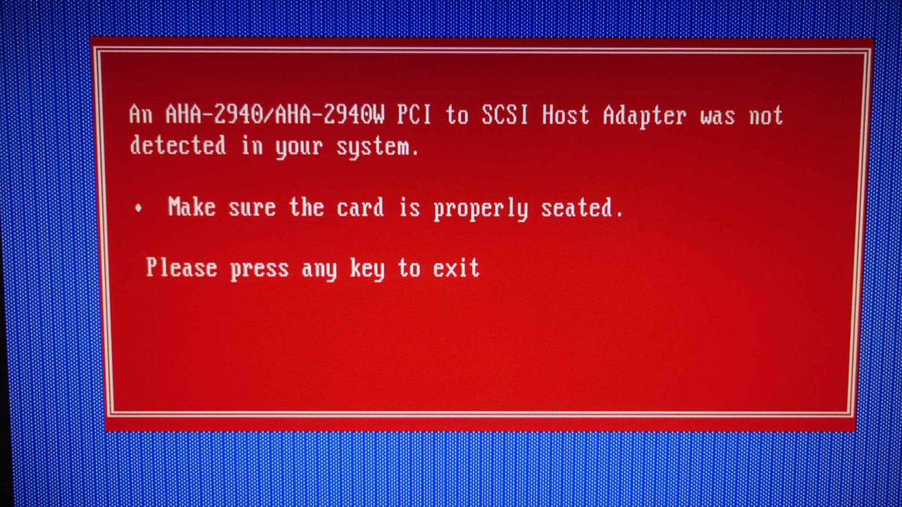

But in order to change it, I would have to go into the utility by pressing Ctrl+A when the screen prompts me. So I did, but I got the following:

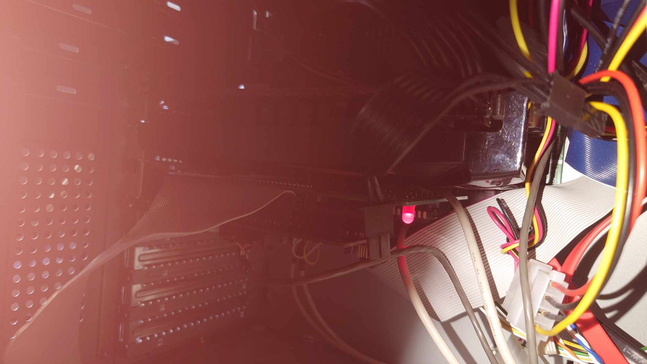

Which is weird, because the card is indeed properly seated and what's more, the LED on it also lights up, but not when I'm in the above screen for some reason. Here's proof:
I'm pretty sure there's some setting I should change with the drive, but the tool won't open as you can see. I also get routine messages that the SCSI adapter bios is not installed, despite it showing that bios v 1.11 is indeed installed in one of the previous screens.

Could be a problem with the card, but before you start blaming it - what mobo is this? Did you try other PCI slots? To make sure it's not one of those "extra" slots without bus mastering capability.

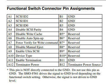

I've gone ahead and attached the manual for the drive.
This drive indeed has an internal terminator that is enabled using a jumper, make sure it's enabled (unterminated SCSI buses can cause all sorts of funky issues, aka "SCSI voodoo" or "SCSI black magic") and that you have no other devices inbetween. The chain must be terminated at both ends (the card and the last device in the chain)

I don't think the manual states clearly enough how to terminate this drive with a jumper. Best I could pick up from it was that a3 is scsi #0 and b3 was GND, so my best idea was to put a jumper on A3/B3. The card terminates itself automatically though. But yeah, quite possibly if I figure out the termination on the drive without bricking it first, it might work 😁
EDIT: Never mind, it said that A11 is responsible for termination. Does that mean I should put a jumper on A11/B11? What about the one on A3/B3, do I need this mechanical indication that the drive is meant to be scsi #0 even though it is already recognized as such by the system?
Reply 5 of 29, by Vynix
Yes, try with a jumper on A11/B11, as for the SCSI ID, you can set it to ID 1 for testing, it shouldn't hurt anything.

The fact that the bios shows on boot and detects the devices does indicate the card is working.
Why the scsi bios setup and scsiselect utility isn't finding the card is indeed not normal behaviour and suggests that whatever the scsi bios setup & scsiselect util are trying to find is incorrect.
Could be a simple PCI device ID or revision that is incorrect due to eprom corruption. at the moment I'd guess that it is fixable, though no idea how 😀

If the BIOS of the card indeed is trashed, that could explain why.
However, from what I can find there's two variations of the 2940/2940W, one that has a surface-mounted PLCC EEPROM and another (older?) with a DIP EEPROM.
Sounds like you're going to have to use an EEPROM programmer to reflash the BIOS

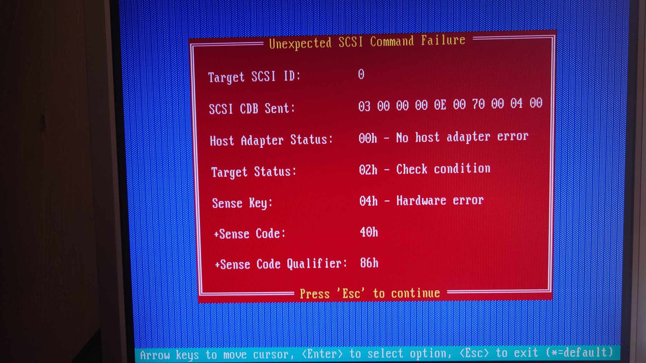

Ok, I've replaced the SCSI controller with an AHA-2940AU with bios version 1.32 and it's detected fine, SCSISelect opens ok and recognizes both the host adapter and the drive. So I think the adapter definitely isn't faulty. However, the problem in Windows still persists, inserted disks cannot be read and the error message is "I: is not accessible. The request failed due to a fatal device hardware error". Again, mechanically the drive seems OK, it accepts and returns drives and the LEDs display in correct colors. Might I still be missing some driver (maybe for Windows), or could this be a SCSI setup thing?
EDIT: I was able to get the drive to open a 9.1 GB disk one time. It failed to format it, but the volume became accessible and I was even able to put some data on it and then delete it. But after resetting, I've been getting the same "hardware error" message for this disk and other ones too. Makes me think it's either some mechanical defect with the drive or just lack of proper drivers.
This is what I get when I try to check a drive in SCSISelect. I'd appreciate if you could let me know if it's a mechanical problem with the drive, so I can return it.
Or could it be that I'm missing some jumpers still? The termination one is definitely set (jumper on A11/B11). Here's the config of the jumpers, are there any that I'm still missing? Maybe the one for enabling fast SCSI?

Spiffles wrote on 2024-08-12, 09:28:
Could be improper termination or cable damage. If your cable has other free connectors - try them. Usually you'd want the two opposite sides, as to not leave any dangling splits that would cause interference, but it's not that bad that it wouldn't work. Not with an older 50-pin cable anyway.
Another option is to try and limit the SCSI speed in the card setup for that particular device. Disable sync transfers maybe.

I've got both terminator and terminator power jumpers on the drive, so I think it's terminated properly. As for the cable, it's got 3 plugs ans I've tried all 3 possible configs with them - one end to the nearer plug on the other end and one end to the farther one - both sides. Still the same error. Regarding lowering the speed, scsiselect doesn't let me adjust that option. So I might try another cable, although my current one appears to be good enough for the drive to be detected by the host controller, so I really dunno. Hoping it's some bad settings since this drive cost me a fortune
Reply 19 of 29, by Deunan
Spiffles wrote on 2024-08-12, 12:10:
Terminator power is a tricky thing. I'd try to disable it on the drive side. Then try to disable the termination on the drive completly - see if it changes anything. Try disabling Ultra on the drive as well, via A9 jumper (but leave the termination on) if the card doesn't seem to offer link downgrade options. I only have AHA-2940UW and UW2 cards, these do have plenty of link options.
