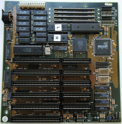

Running it on a 286 pc.
The mobo is Tomato TD60C (Harris 286 @20MHz, Citygate D90-272).

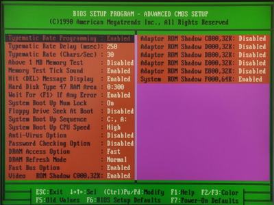

The "Shadow+Special RAM Size" is shown as 'N/A', though the mobo does shadow the roms, and bios has configs for it.

The photo of rom shadow options from the bios, just to indicate it's there while system info reports N/A:
153.12 KiB

- Fixed reporting of shadow memory size on 286

Reply 16 of 124, by zyga64
Ok, this is my 286 rig:
Unknown VLSI SCAMP (VL82C311L/VL82C113) board (possibly PC CHIPS).
Amibios string: 20-0001-001223-00101111-0505910-KB-8042--0
- CPU: HARRIS 286 20MHz
- RAM: 4x1MB SIMM

Ran HWINFO16 on my 286 today, a Siemens 16Mhz CPU with a Headland HT12/A chipset. When I run Drive Information, when it reaches […]
Ran HWINFO16 on my 286 today, a Siemens 16Mhz CPU with a Headland HT12/A chipset. When I run Drive Information, when it reaches Quaternary I get:

When I run HWINFO16 with the -d -r parameters, it generates the attached log files but hangs on the main screen after it has (presumably) finished.
Do you know the name of this main board?
Unfortunately, no. It's a clone board. This is a photo of it if that helps.
545.03 KiB
