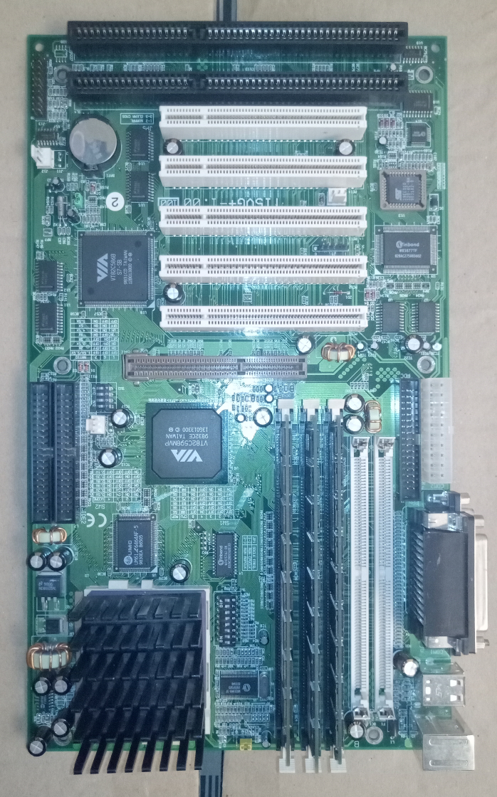

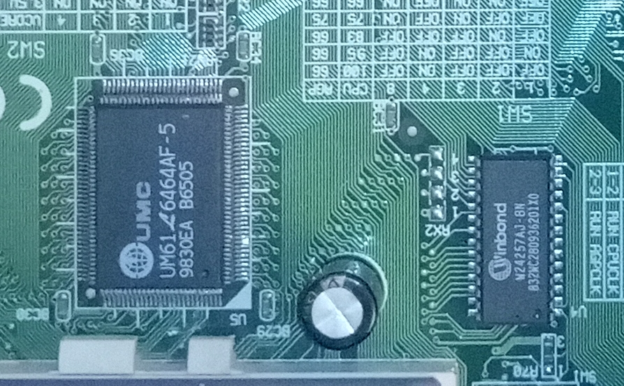

I took some photos of the Ti5VG+ and it seems it has a TAG ram of 512K as well as two QFP128 pads, one on the component side and one on the back, if I am not mistaken, see photo.
TI5VG+ with 512K SRAM and TAG 512K
Rear view with PCB pad for additional SRAM QFP128 ?
This SRAM / TAG is currently on the board
Does anyone know if the rear pad is a "real" pad and if it´s possible to solder two 8Mbit SRAM chips to it to replace the current 4 Mbit one?
Reply 4 of 4, by majestyk
Wishful thinking, you should have kept your MVP3-G5 😀
The TAG chip is 256K, 28 pin [32K x 8] - don´t bother about 2MB cache.
_All_ you can do is add a second 512K cache chip on the flip side or maybe replace the existing 512K by a 1M chip. The 2-chip solution is superior because L2 interleave is possible.
The limits for cacheable RAM area are 256 MB (write through) or 128 MB (write back) with this setup. Many MVP3 boards don´t offer WB L2 due to BIOS limitations or they switch between WB / WT automatically depending on RAM size.
