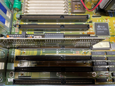

Hello, hoping somebody could point me in the right direction with my 386. It's having trouble booting.
So the symptoms are:
1. Upon boot there is a memory check, and reports '1664 kb ok' - I have 2 x 1mb simms in there, so this seems off
2. After the memory check I get 'CMOS battery state low' - this is a barrel battery I replaced about 18 months ago - multimeter gives a stable 4 volts (battery is a 3.6v 80mAh)
A couple of other data points:
1. 'did it ever work?' yes - I have used this PC without issue many times
2. There is some mild marking around the battery area from a previous battery that I removed when I received the motherboard. It was cleaned up and I don't see any damaged traces.
3. No BIOS settings will stick, even on a soft reset
I'm going to see if I have any other simms around, or remove them completely to see if I get different behavior.
Thanks!
