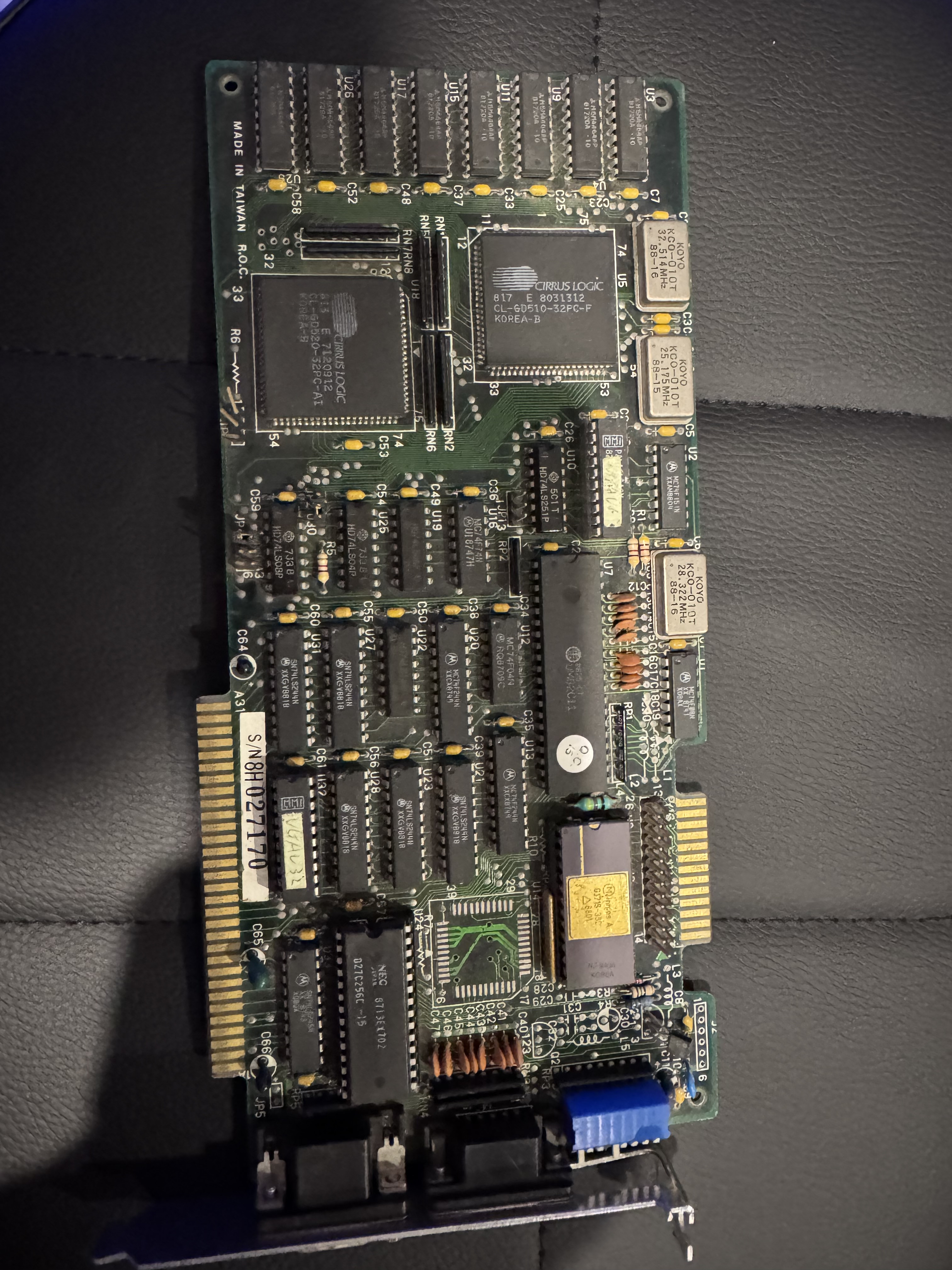

So, I got a nice XT system however it onyl comes with a 9pin monitor output and so I would like to output the image to my VGA CRT monitor.
I have done bit of googling and basically people say that I can use most 16bit video cards and put them in the 8bit slot, it will overhang but no issues, should be working perfectly fine.
so i went out and bought this specific VGA ISA card as its supposed to work and does not require jumpering.
I plugged it in and the moment I turned on the PC, I got loud pop and one of the components blew up. I quickly turned the PC off and removed the card. I think the PC is still working as its starts ok and makes usual booting sounds etc.
However, the card is probably dead, see photos of the card and the part the exploded. It was quite the fireworks.
So my question is, which card can I use ? I have few more ISA cards but afraid to put them in so I dont damage them. I can post images of all of them if that helps.
link to photos https://postimg.cc/gallery/23C15xn

Reply 1 of 31, by konc
It's just an old capacitor that failed spectacularly. It's common with this type of capacitors, it can be easily replaced and had nothing to do with the card being inserted in an 8-bit slot.
That said, the 8900C is indeed supposed to work in an 8-bit slot.
There are quite a few others too, mostly chips from Trident, Paradise, Cirrus Logic, OAK and some more.
You can list your cards here of course. Note that even though a specific VGA card with chip x works, another implementation on a different card might not.

Reply 3 of 31, by vstrakh
Omarkoman wrote on 2025-05-12, 08:50:
So you reckon it was just bad luck with that one card? I can try another one , just worried it might blow up as well!
Luck has nothing to do with it. It's a property of the old degraded tantalum capacitors. With age they get shorted internally, and then they blow up when you power the device.
You just replace that single capacitor, or at least just cut it off if you can't replace it. The card itself is ok.
Another card of the similar vintage has exactly the same chances of blowing up, and it has nothing to do with slot width or position.

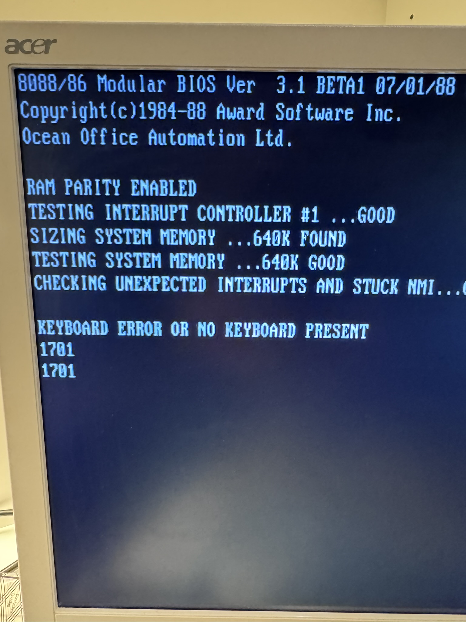

Reply 17 of 31, by Omarkoman
Btw i tried 4 cards including the 8bit one, no image output on the screen. So probably need to change those dip switches for vga?
Reply 19 of 31, by wierd_w
Omarkoman wrote on 2025-05-12, 20:47:
Always, with ega/vga. They have a video controller bios, which is what this switch actually does: disable the video bios for MDA and CGA baked into legacy bios code.
