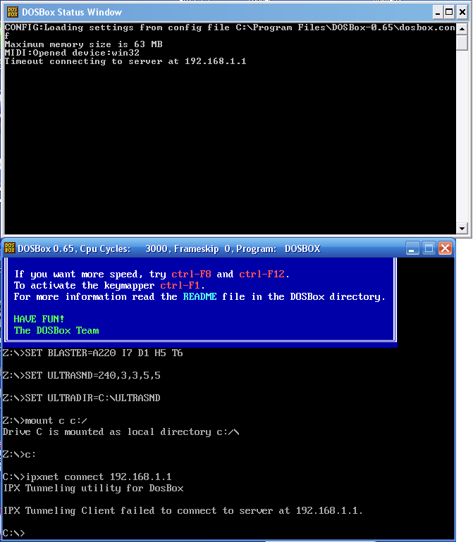

Reply 4 of 4, by bowserjps
I put "ipxnet connect ip address", but it always fails.
Local Area Network does mean IPX
