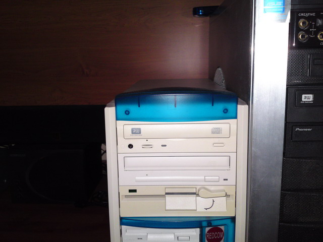

6x Teac CD-ROM Drive
Master (for classic dos cd gaming with CD Audio Connection with AWE32)
Lite-On DVD-RAM RW Drive Slave (for archival purposes, and for using with custom made DOS DVD versions of multiple CD games. Works well in both DOS and Win3.11.)
1x Teac 5.25" FDD
1x Sony 3.5" FDD

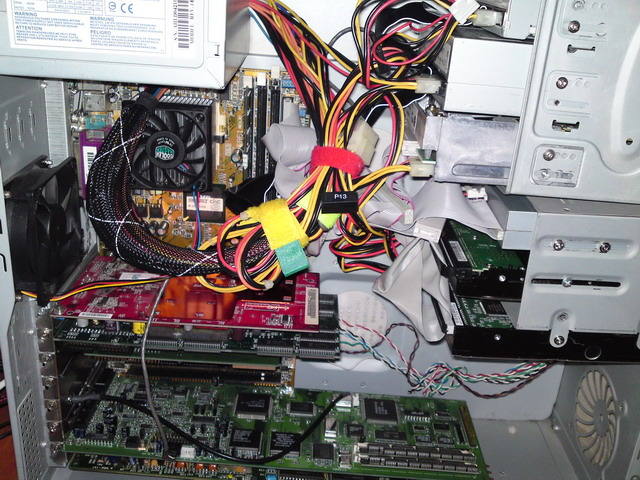

9. The Hard Drives are mounted upside down for optimum heat reduction and this is the only convenient way with respect to the case's racks.

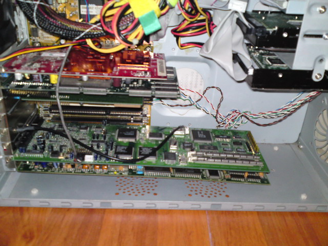

10. Both the AWE32 and LAPC-I are competing in Who's the Longest competition. 😁 Though not very clear in the picture, the LAPC-I still leads by a quarter of an inch. In fact, it's so long and since it's only an 8-bit card, as you can see, the end of the board is slightly deviated down due to gravity.
The AWE32 has additional 2x16MB 30-pin SIMMS (28MB Available). Using 8MB GM ROM samples.

I suggest you support that Lapc-I in some way..it's not good to have it hanging like that..it put alot of stress to the card.
Remember you have to shell out $150-250 on Ebay if you want a replacement 😉

Right on. I think I'll place two small rolled pieces of paper beneath it for support. The concentric circles of the rolls should be able to withstand it.
Here's a picture of it.
The best part I like about this board is the front panel connectors. All the pins are directed horizontally, parallel with the board surface. And also it's placed away from the ISA slots. This is very useful for long ISA cards.

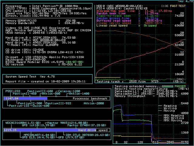

Here is the System Speed Test v4.78 results for this system...
