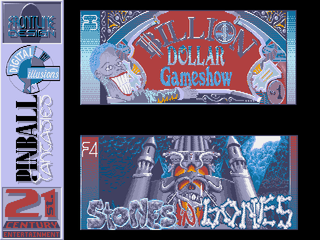

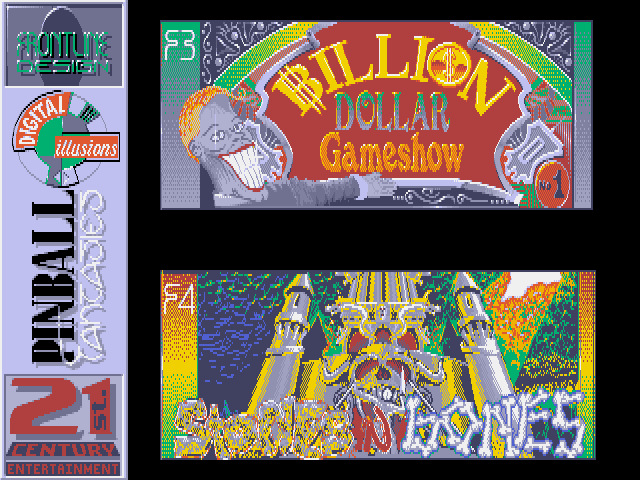

Pinball Fantasies uses 2 palettes simultaneously (top half and bottom half of the screen) in its intro screen but dosbox does not render it properly.
I have tryied machne=vgaonly but it did not fix the issue.

An interesting side-effect is that you see the wrong palette for the lower picture on the screen, but a screenshot taken by DOSBox (Ctrl-F5) has the correct palette for the lower picture.
    21.5 KiB
    1718 views
    Screenshot taken by DOSBox
    21.48 KiB
    1718 views
    Screenshot taken by Windows
Reply 5 of 11, by ripsaw8080
Rank DOSBox Author
DOSBox Author
I used my own build of (fairly) recent CVS with svga_s3. I just now tried it with vgaonly and the palettes are working correctly. I thought the OP said that it had been tried... guess not.
