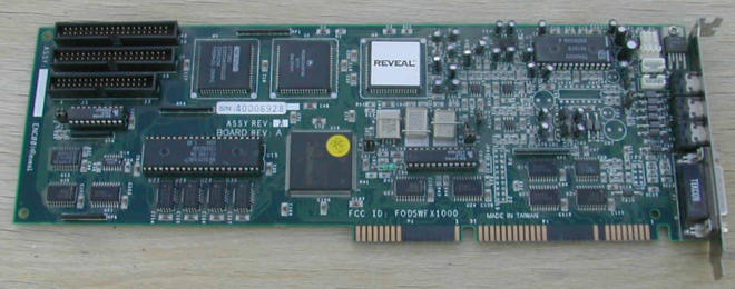

One of the chips says - Ensoniq OTTOR2.
Near the ISA slot connector, it says ...SWFX1000.
(I haven't got my grubby mits on it yet, so that's all I can really tell you at this stage.)
Here is the seller's somewhat amusing description -
What I believed was either a single board computer or micro controller of some kind is actually a Reveal wavetable sound card. Someone was kind enough to point this out. [RG100: Was that someone Sherlock Holmes, by any chance? 😉 ] Marked on the front is EN001:Reveal and on the back CADAC CMVO-1 E77755. The board has a Motorola MC68EC000FN8 processor, what I assume are 2 IDE and 1 FD connectors, video and sound. The support chips are Ensoniq. I did find some information in a Google search, but nothing definitive. The small amount of onboard memory is probably video memory so will need a memory card to use. It has been in my garage a long time and I don't recall where I got it. Since I will probably never use it, it goes. I hope someone has a use for it. I don't have anyway to test this, so am selling it "as is".

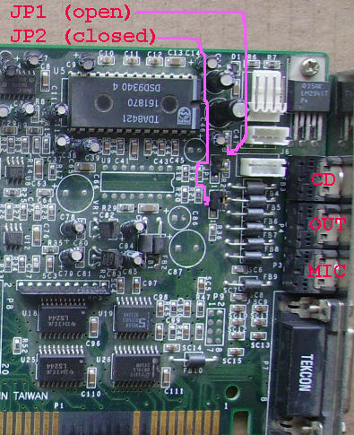

Finally, I don't know where the tone controls can be adjusted, if at all. Perhaps I need to DL some software, including a mixer. I'll go back on to driverguide and have another look. Perhaps tomorrow. Incidentally, if I get hold of a mixer, maybe I can shift the "sound balance" over to the left ear! Just one last thing - looking at the photo in the O.P, look at the white CD plug thing on the top right hand side. There's a couple of them there. Look at the bottom one. Then next to that on the left is an empty jumper. I wonder if it needs to be capped, to get the stereo working correctly? Just a complete guess really. Probably a daft idea. (I need to pull out the card tomorrow and take a closer look at things.)

Edit: I will take a photo, then label the jumpers by hand using "paint brush".

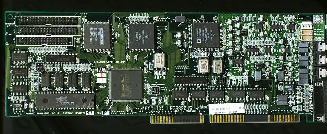

I did this in 3 parts. The photos go from right to left.

Reply 8 of 13, by retro games 100
cdoublejj wrote:
Thats pretty good quality you can even see whats printed on the ICs.
Yes, it came out much better than I expected. I put the soundcard near a window to get some good light on it, and took about 8 pics of varying distances between it and the camera, and that seemed to produce a couple of useable pics. 😀

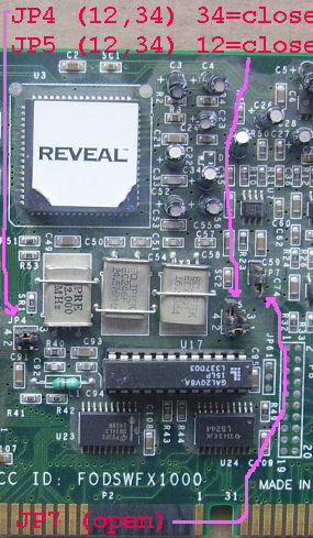

Jumper info from Usenet:
JP3 CD-ROM Select
None=Disabled
1-2=Sony
3-4=Mitsumi
1-2,3-4=Matsushita/Panasonic
JP4 Base Port Address
None=350H
1-2=340H
3-4=330H
1-2,3-4 320H
JP5 Wave Port Address
None=F44H
1-2=534H
3-4=608H
1-2,3-4=E84H
Card's official name may be "Reveal Sound FX Wave 32".

I'm very pleased, because my guess about capping jumper JP1 to get stereo sound turned out to be correct! Now it's capped, the card sends out stereo sound to my headphones. But fairly typically I suppose, when you are messing about with things on an 'ad hoc' basis, I cannot be 100% certain that capping JP1 was the key to solving this problem. Because, now I have reinstalled the card (plus the "W95b38.exe drivers", which included the driver files Sndscape.so0 thru to Sndscape.so4), inside the basic windows audio mixer settings, I now see a column for "Synthesizer Balance". (You can't move this slider to the left or to the right, but you can adjust its "up and down" volume slider.)

Sorry, I'm being a bit stupid. I just did the most obvious follow up test. I removed the new jumper cap on JP1, restarted the machine, and the stereo sound has vanished - the sound has reverted back to mono. So, JP1 does control stereo, or rather, it forces the card to go in to mono mode. Incidentally, removing the JP2 jumper cap as well seems to remove mono sound, effectively muting the card's OUTput so you hear no sound at all.
