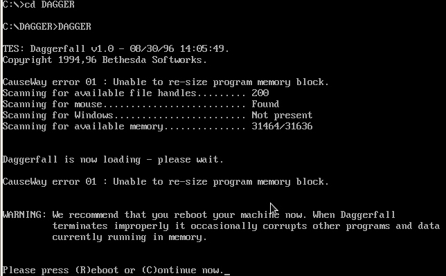

I'm having problems in getting the mentioned game to run.
I did everything as described in the official howto from Bethesda, but here is what I mounted:
mount c ~/dosbox -freesize 1000
mount d ~/dosbox/DFCD -t cdrom -label Daggerfall
(which gives the error "MSCDEX: mounted subdirectory: limited support")
The installation size was set to "huge" and when I try to start the game, I get a causeway error 01.
I'm using Fedora 13, Dosbox v.0.74 and the version of Daggerfall that is avaiable on Bethesdas site.
I attached a screenshot of the error message.

No, the directory mounting as cdrom is per the Bethesda guidelines and works fine. Not sure what's wrong here. cpytype=normal is incorrect, but I doubt that could cause any problems? FWIW, my DBGL gamepack is also made using the steps from Bethesda, and works without problems on Fedora.

Error 0 means that the paths in Z.CFG are wrong, which means you didn't install the game correctly.

I don't think so, it might have something to do with dagger.exe not recognizing the config file, because when just executing dagger.exe, it outputs the causeway error, but when executing fall.exe z.cfg, it outputs the error 0.

The normal core works fine. The reason why older guides recommend the normal core, is because back in the DOSBox 0.65 days (or whenever it was), the dynamic core didn't work well with Daggerfall and caused graphical glitches.

I don't think it's reproducible on a real system, not even in DOSBox. I just installed Daggerfall 1.0.165 in DOSBox 0.74 and ran with memsize 16 and the game launched just fine. I've also played Daggerfall on a real 16MB DOS system for hundreds of hours and don't recall of ever getting any "CauseWay error 01". While error 0 is fairly common.
I have absolutely no idea what longdouble may have done to get the CauseWay error. There is an "UNABLE TO ALLOCATE OBJECT MEMORY", but it's obviously not the same, and was fixed in a patch anyway.
Unpatched Daggerfall should be very much avoided, as it's buggy as hell. The first thing anyone should do is to install the latest 1.07.213 patch, although I didn't do that now to see if the CauseWay error would appear in the unpatched Daggerfall, but it didn't.
