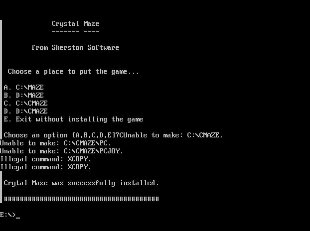

To install the game i put (E:/ is my cdrom drive where the game is)
E:/> dir /w
E:/> install.bat
then a list of options came up - see attachment. But i've tried all of the options and they all say the file couldn't be made but that installation was successful - but it wasn't!!!
    28.19 KiB
    1138 views
    print screen of unsuccessful installation

Since it's trying to use the command xcopy to install see this thread.
How to get games which install with XCOPY to work - GUIDE
