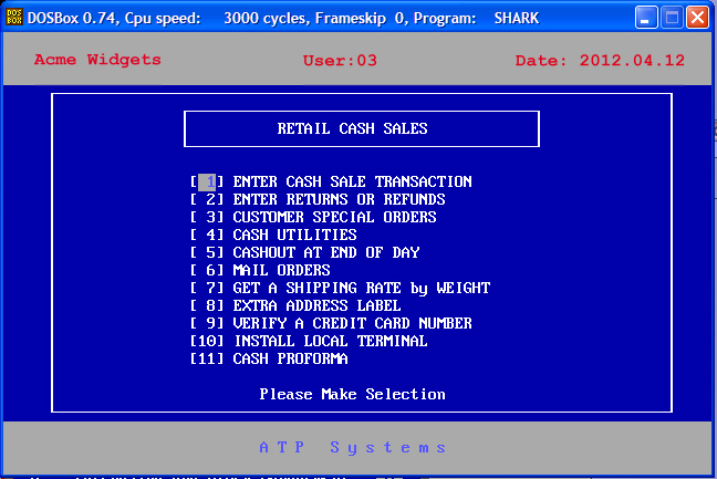

Reply 7 of 9, by hoserjoe
Clipper was always a giant pain this way, which is why VP-Info (later Sharkbase) was so popular. Shark could be networked easily, wasn't a memory pig, no licence required (shareware), could import & export data, and it was dead reliable. As a result, it still runs nicely - in DOSBox.
    189.62 KiB
    1106 views
Reply 8 of 9, by Joey_sw
oh? you decompile the clipper-based apps and re-create using sharks?
i remember hellish experience using RESCUE5 to salvage any non-encrypted functions from clipper apps, the horror.
-fffuuu
Reply 9 of 9, by hoserjoe
You don't decompile anything; you need the source code. Shark is a compiler. The shareware version is called "SR-Info". The language is similar to dBase, which in turn is similar to Clipper, except that Shark accepts unlimited records and has a compiler. You have to adjust the code slightly to compile in Shark. Clipper is a huge headache to deal with, which is why so many businesses turned to Shark. I'd rather hurl myself off a bridge than try to run a Clipper app! Previous versions of Shark were called VP-Info. See
http://books.google.ca/books?id=zzAEAAAAMBAJ& … epage&q&f=false
