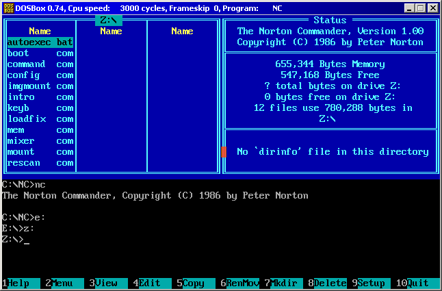

I run NC as "G"UI in DOSBox, mounting my cdrom as e: while starting up. Title says it all, it does show up. When i mount my usb-floppy, it does.
I've tried every variation i can think of, both mouting order or options, i just cant get it to work. Thing is, on my last pc (which was running xp) it did!
I know, it's not a big deal, since i can type my way down the cdrom, it just makes me MAAAAAAAAD because i know that somehow it did once!

Reply 10 of 19, by ripsaw8080
Rank DOSBox Author
DOSBox Author
In addition to menu choices, NC should also pick up on a current drive change typed at the prompt in the usual way, what happens when you do that?
I've tried NC 1.0, 3.0, 5.5, and Volkov Commander 4.05 (NC clone) with cdroms MOUNTed and IMGMOUNTed with various drive letters, and have no problems seeing and selecting the drives. The app doesn't seem picky about drives in the least.
DOSBox's Z: drive is also in the drive list, so could indicate a drive letter limit of some kind if Z: isn't showing up.

Reply 16 of 19, by ripsaw8080
Rank DOSBox Author
DOSBox Author
If you don't see the Z: drive, is cdrom even relevant to the issue? i.e. does a second HD mounted as D: show up?
NC 1.0 has no problem seeing drive letters after C: regardless of drive type. The version you have seems to fall between the 1.0 (1986) and 3.0 (1989) versions I've tried, but it's strange that it has the issue you describe while the others do not...

Reply 19 of 19, by lucky77
So, i'm back!
Got me NC 2.0, shows all the drives. Installed my 1.02D on XP, works fine as well.
Must be some odd luck it won't show up my win7 with this very config.
