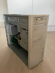

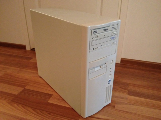

Brief description
Originally from a Finnish system integrator called Wings. I only kept the case because it's sturdy as hell and roomy enough to run an old system with just passive cooling. In fact the Slot1 CPU in this thing only has a huge heatsink on it. The PSU located right above it pulls warm air right out of the case. This makes the computer very quiet in operation. For maximum performance in late 90's and early 2000's titles, the system packs a GeForce 3 Ti200 which has excellent performance and driver support, and gives a nice clean image on the CRT. The AOpen AX6BC Pro II Millennium Edition could be blamed for starting the bling-bling trend on internal components with its stark color PCB, ridiculous naming, silver name plaque and "25 karat platinum" heatsink. 😆 For what it's worth, this is actually a very good, stable motherboard. Other peculiarities feature the DVD-drive which has a region-free "service" jumper. OS of choice: Windows 95 OSR2.

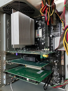

I'm guessing the CPU heatsink is from some big brand OEM originally?

The Slot1 CPU was apparently originally in a Compaq server. I bought it used and it has served me well. I have no way of monitoring the temperatures but there have never been any stability issues (nor does the heat sink get very warm) so I believe it's fine. It is one big loaf though. The case weighs a ton.

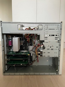

2021 upgrades with new pics
After having an existential crisis, Longbottom has rediscovered itself as a more powerful late 90's/early 00's gaming setup...

The AX6BC Pro II Millennium-edition is a fantastic motherboard... except for the floppy connector placement. UGH. 🤦
Also if you wanted to do a retro-build, this is clearly intended for post-DOS gaming since there are no more ISA-slots for real retro sound-hardware.
It's fine, as its older brother has me covered for those.

Here, showing off the massive PIII heatsink that was the topic of conversation earlier on. The new graphics card (a GeForce 3 Ti200) runs so hot I decided to mount a quiet 60x60mm fan on it. The cards have been spaced out for proper airflow, but also ensuring none would share interrupts.
