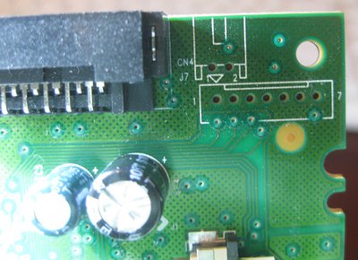

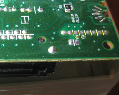

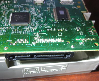

Reply 7 of 26, by feipoa
Jr_ wrote:
I think the only way to do that is opening the drive to see if there is any solder spots to get analog audio out.
I've seen many SATA drives and none of them had that physical connector as the IDE drives
That is a good idea. So I took it apart. Here are the photos. There does appear to be some kind of missing connector, but it looks to be a two pin connector, which would likely be for a digital audio cable. There is this other block of solder pads next to it though, perhaps analogue audio?

Reply 8 of 26, by alexanrs
I've always been curious about it. AFAIK the drive still responds to the audio playback commands, there is just nowhere to get the sound from. Does PATA drives have special circuitry to handle áudio? Does the optic units have dedicated lines in their connectors to the board to send analog áudio? If so, could these be soldered and sent to a separate board piggybacking the drive? Oh well, sadly enough I'm out of spare SATA drives that I can open and wreck. I do have a spare PATA one that isn't reading disks though, when I have the time I should open it up and study it.
Reply 9 of 26, by obobskivich
2-pin is generally for digital audio, yes. In order for analog to work it will require a complete D/A circuit with output opamps and so forth - does it have any of that componentry available?

Reply 12 of 26, by feipoa
The PCB contains 3 integrated circuits, all of which I have been unable to locate spec. sheets for. They are,
BD19960
NEC
MC-10045
1005EB001
R2A3
0253
SP
The MC-10045 seems to be the proprietary Sony Optiarc chip. Without the spec sheet, I cannot determine if the analogue audio functionality is integrated into this chip.
As none of the pins in that 7-pin solder pad block were ground pins, I am assuming there is no missing analogue audio header. For those 2 pins which comprise of the missing CN4 header, one is ground. I am left with no alternative but to remove the SATA drive in favour of an older ATAPI drive with analogue audio.
