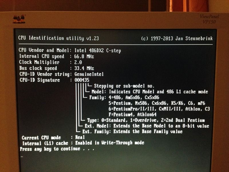

I have a 486DX2 system with 8mb of ram and a video card of unkown origins. What I do know about the card is that it is a multi IO card with intergrated Cirrus Logic CL-5424 chipset and is an ASI-VLB card. It seems like this hardware should be able to run stuff like Doom and System Shock without issue, and it certainly meets the requirements detailed on System Shock's listed requirements, and yet it runs like a slideshow. Any ideas on what might be slowing things down? Let me know if any other info is needed.
Here are my bios settings. I have since enabled the cache and the A20 setting, which has improved things, but not to where it seems like they should be.

My results:
3dbench - 305
PCPbench - 7.7 i think?
Doom - Don't know, says "bad command or file name - press any key to continue."
Quake - Don't know, nothing happens, just reloads menu.
CHKCPU -
Reply 5 of 22, by Guybrush3pwood
Ok...so i compared...i was faster than one with the same processor but slower than everyone else with the same processor. So, it's slower, but I knew that already. Not entirely sure what to do with this info.

Tells me a lot. The first score makes no sense. It's way too high. You computer having trouble with Doom and Quake is also of concern.

You've done cache and A20
The other possibles, maybe you can lower the DRAM wait state from 2 to 1 or to 0 - run a memtest to see if it holds up at lower WS.
Decoupled refresh enabled may be better.
Shadow RAM = main - what other options - if "main + Video/vbios" then that would be much better for anything accessing the Vbios.
Alternatively, running UNIVBE may improve video operations.
