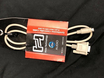

Hosa manufacturers a fairly inexpensive 8-pin mini-DIN to DE-9 cable:
http://hosatech.com/product/dbk-100/

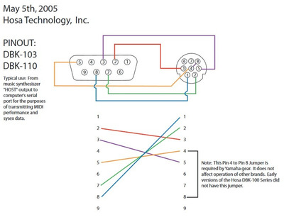

Do you, guys, think I can make a 8-pin mini-DIN to DE-9 cable, like above, myself? Are there any electronic components inside, or it's just directly connected? There is the official pinout of this cable

It's a piece of cake, unless it has anything else except wires inside.
EDIT: Here is complete manual. More details on second page. No mention of any additional components...

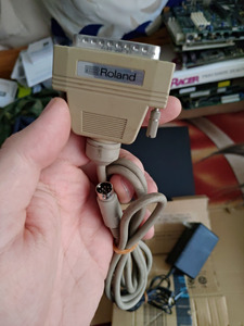

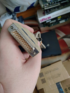

Okay, I don't know if I am stupid or what the heck is going on but I got SC55 Mk2 which should be able to use the COM port communication. Also I got the original Roland RST-15AT cable and when I tried to plug it in and set up the same way as shown in the video, nothing happens. I tried to google a lot and I found out that there is the swith with mode 1 and mode 2, mode 1 being for Mac, mode 2 being for PC. Also I found out that the device should be communicating on 38400 bauds. How do I set up the port this high on DOS machine? Is it possible or do I need Windows for that?

Thanks guys. It turns out - yes, it is me who is stupid. Just brew myself a cup of tea, sat down and start thinking why the frick it is not working. Can you spot what's up? 😁

Reply 17 of 19, by krivulak
Indeed I did. I was plugging it blind by reaching my hand behind the computer and both ports are on top of each other. Plugged it in without knowing it is the wrong plug and then proceeded to make myself angry because it didn't work. Whoops
Reply 18 of 19, by digger
Well, to be fair to you, it was indeed confusing that Roland decided to include a serial cable with a male 25-pin connector instead of a female one, which would have made much more sense, and wouldn't have required either another cable or a gender changer.
