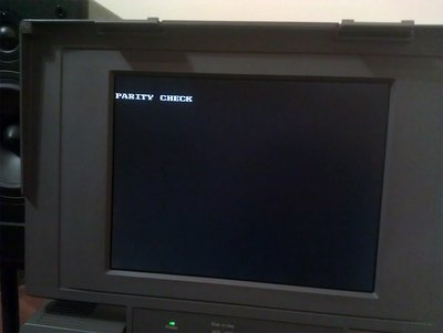

I noticed that sometimes (rarely) computer freezes, screen turns into CGA mode and displays PARITY CHECK message.

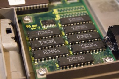

It has 6 SIMMs installed under keyboard (easy access) and one megabyte of onboard DIP memory chips.

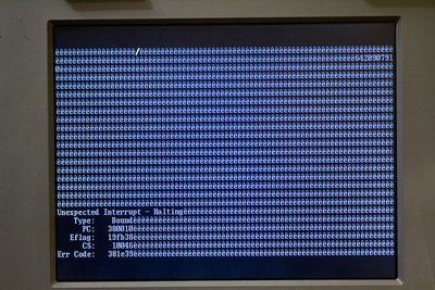

Then I used memtest (version 1.3) and immediately the screen starts flashing, it is full of letters and after some time an error appears (unexpected interrupt). With version 2.5 it shows unexpected interrupt after start and it halts.
The behavior is the same with or without additional memory.

Are there any different utilities I can use to check memory? Could it be faulty coprocessor? Or even CPU?

If that's the memory, i guess that desoldering onboard chips might be helpful? Maybe it will work just with memory installed in SIMM sockets, if not, then I can solder some DIP sockets and put some different memory chips.

I installed DIP sockets and put some different memory chips (i used chips of different manufacturers as I don't have a complete set of the same chips) - and that problem with Memtest still appears. Funny thing is that these "eeeeeeeeeeeeee" errors turned green now. Maybe I still have some defective chips there?
I also tried Memtest 4.0 and it just halts with unexpected interrupt at the beginning. Another funny thing is that this computer starts even with all memory modules removed, and with no onboard memory - and it shows First 64KB memory Error or something like that (and it halts there).
Does anyone have some other DOS utilities for testing stability of 386SX?

DUDE YOUR TOSHIBA HAS A VIRUS!!! I just ran into this exact same problem on a Toshiba T3100e, found this thread, and was convinced it was some kind of hardware issue. Then I put a floppy disk into my modern PC to transfer files over, and Kaspersky notifies me that the A drive is infected with Virus.Boot.Parity.b. Looked it up and found this wiki page which explains everything:
Systems infected with the Parity Boot virus may experience the following message being displayed after keys are pressed on the s […]
Systems infected with the Parity Boot virus may experience the following message being displayed after keys are pressed on the system keyboard:
PARITY CHECK
I know it's been five years since you posted this thread and you may no longer even have the computer in question, but I thought I'd let you know what I discovered! It's not a memory problem at all!
