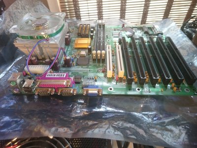

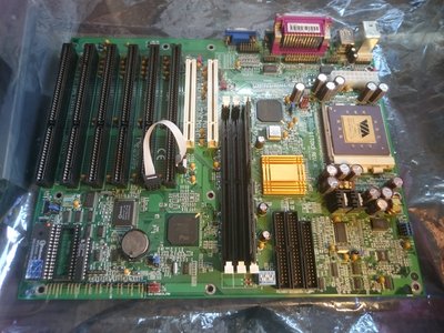

Okay, I've come to the conclusion that I'll never finish a build unless I start a thread documenting it. And even then, I may never finish it!
I thought I knew all the components for this build, but over the years, it has changed many times. I have two different boards in mind using VIA C3 Ezra-T CPUs - this is the first build. Specs:
Board: DFI ITOX3
Chipset: Intel 440BX
CPU: VIA Cyrix III, 1Ghz Ezra-T
Memory: 256MB SDRAM, CL2
On-board VGA: Chips & Technologies F69000, 2MB
The rest is subject to change...

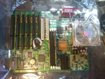

So, this is the starting point, and some pics:
3.2 MiB
2435 views
DFI ITOX3
3.13 MiB
2435 views
With HSF
3.11 MiB
2435 views
On-board VGA
2.72 MiB
2435 views

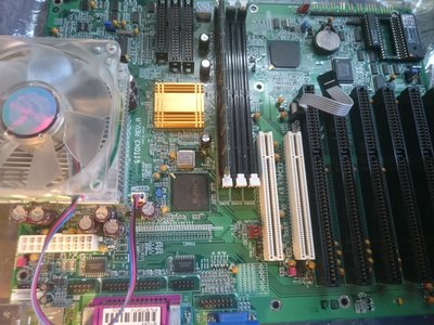

You can see the board has a SB-Link connection, so even though there are 6 ISA slots, I won't be able to resist chucking in a sound card like a YMF724...

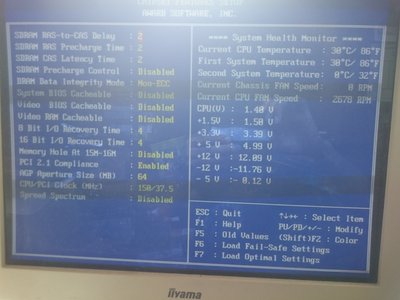

I don't know much about the F69000 VGA, I believe Intel bought out Chips & Technologies. It's only 2MB, and probably slow. It does have a BIOS option forcing 60Hz, which I've noticed fixing aspect ratio in ZOOL. It has BIOS options for CRT/ LCD which seems unusual. I'll probably change to another VGA card...
That heatsink fan looks quiet being 80mm, but it's noisier than some 40mm fans I have ; it's gonna go. The VIA runs cool, so I could probably get away without a fan. I can overclock the Ezra-T to 1200 Mhz easily, so may keep the fan for that.

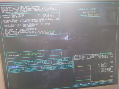

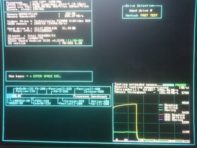

Some temps with the CPU running at 1125Mhz:
2.42 MiB
2435 views
That's it for now. I'm not sure where I'm going with this build, but I'll try to get some benchmarks later (time permitting). And any requests, please feel free to ask.

@Jade Falcon: Voltage control on this board is not easy, so I'll keep stock voltage of 1.4v and overclock around that. It does 1200 Mhz easily, and at 150Mhz FSB. I have a Slot 1 build with a Slotket that has variable voltage jumpers, so that build would be better for overclocking. In my previous tests, this CPU is stable at 1300Mhz, and 1400Mhz if you don't use 3DNow!

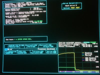

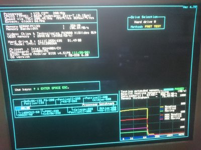

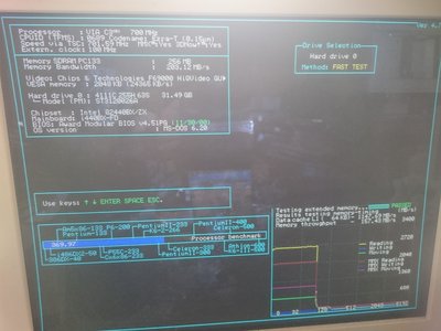

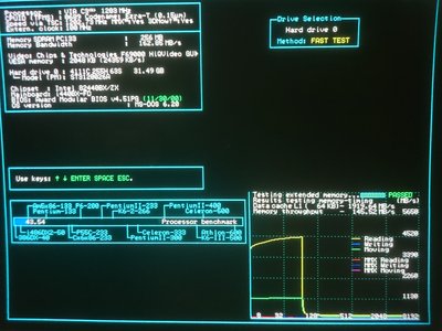

Some quick benches with Speedsys - just used multi and FSB (all Setmul switches enabled, all caches enabled):
2.74 MiB
2377 views
150x8; 1200 Mhz
2.62 MiB
2377 views
100x7; 700Mhz
2.67 MiB
2377 views
66x3; 200Mhz
These benches give a range from the slowest to the fastest by just using FSB via BIOS, and Setmul to change multi. Other speeds are smoothly attainable between these ranges by just using the aforementioned parameters.
In conjunction with ICD (Instruction Cache Disable), and BPD (Branch Prediction Disable), far more flexibility is possible, with a range from 286 to a Pentium II. I'll post these benches later...

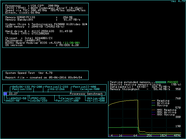

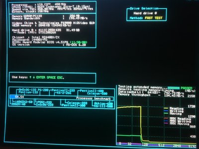

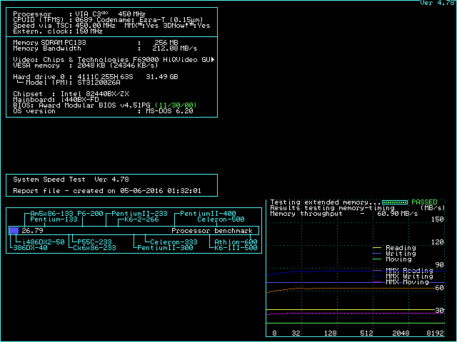

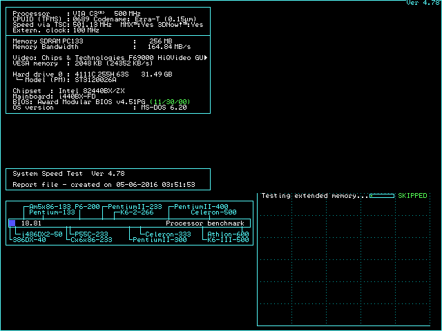

Reply 8 of 44, by j^aws
@clueless1: Yeah, definitely more appreciation in retrospect. I'd have to add that the discovery of VIA C3s having unlocked multipliers definitely helped, especially with SetMul maintained by Gerwin.

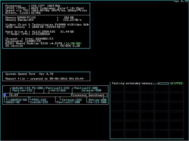

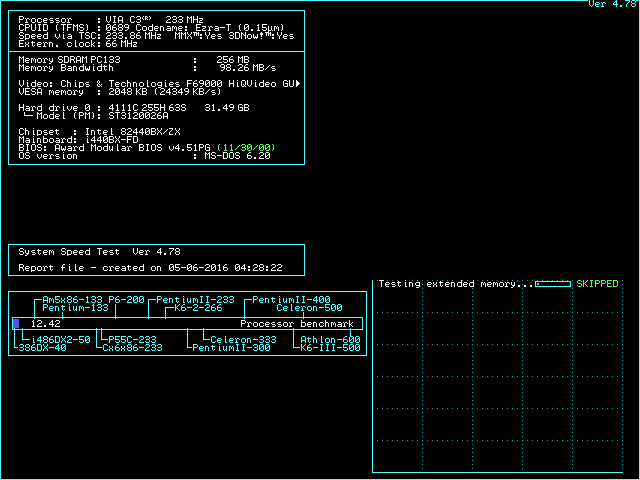

Some more benches, getting slower and slower in obtaining them:
3.11 MiB
2339 views
66x3; 200Mhz; BPD
So, following on from the last Speedsys score of around 105, we are now at 88. I just used BPD.
3.1 MiB
2339 views
150x8; 1200Mhz ; ICD
Now dropping down to 64 in Speedsys; using ICD, and full speed.
2.08 MiB
2339 views
150x3; 450Mhz; ICD
Hitting 54 in Speedsys; dropped multi to 3x.
2.26 MiB
2339 views
100x12; 1200Mhz; ICD
Approaching AMDs classic 5x86-133, with a Speedsys score of around 43... Changed FSB to 100Mhz.
2.25 MiB
2339 views
100x3; 300Mhz; ICD
Somewhere near a 100Mhz 486; score of around 36 in Speedsys. How deep does the rabbit hole go? To be continued...

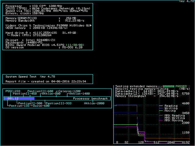

The unique advantage of C3 is the possibility to have universal machine for DOS and Win9x. Faster C3 are more interesting for this. For example, on stock 1200 MHz Nehemiah gives 800 points in speedsys.
This board also runs Nehemiah (only tried 1.45v models), and it is faster clock-for-clock:
7.57 KiB
2078 views
150x8; 1200MHz
The above is at full speed, and is around 170 pts higher in Speedsys compared to the Ezra-T (801 vs 632). The Nehemiah also has a slower bottom-end when disabling all caches, BPD etc., but it doesn't scale as smoothly; it has a large gap from around 15 pts - 130 pts in Speedsys (around the range of 486-33 to PI-133). It would still make a good all-round machine.

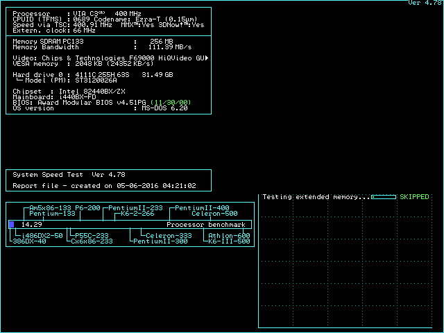

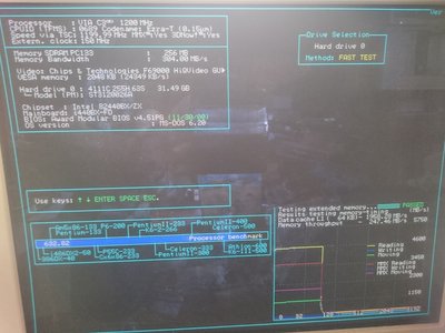

Some more Speedsys tests using the Ezra-T - I last left this at around a 486-100 MHz level, scoring 36pts. The following is with L1 disabled (no L2 for Ezra):
7.21 KiB
2078 views

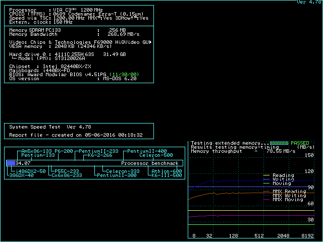

150x8; 1200MHz; L1D
This is the fastest I can run the board with L1 cache disabled.
Some more:
7.2 KiB
2078 views
150x5; 750MHz; L1D
7.06 KiB
2078 views

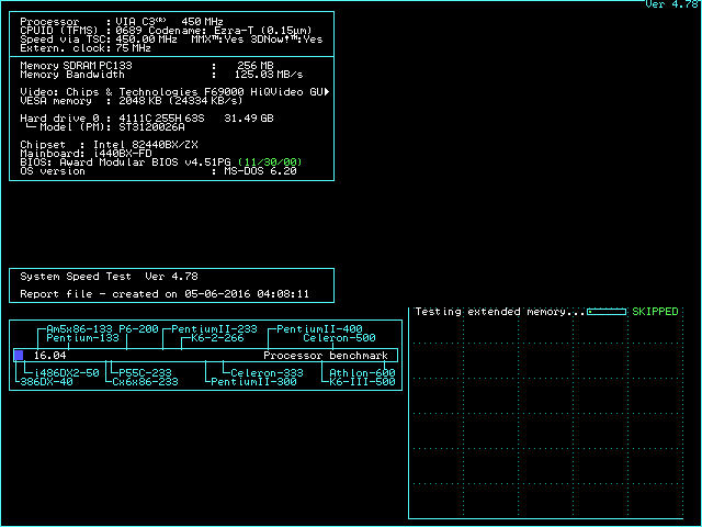

150x3; 450MHz; L1D
We're now somehere in the region of the classic 486DX2-66...
And:
7.52 KiB
2078 views

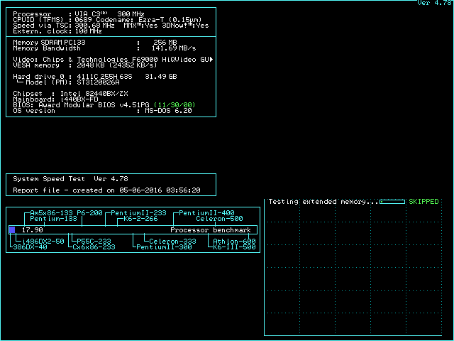

66x3; 200MHz; ICD; BPD
The above is the slowest (~ 22pts) I can run this board with L1 cache still enabled. I used both ICD and BPD with the slowest multi (3) and FSB (66Mhz).

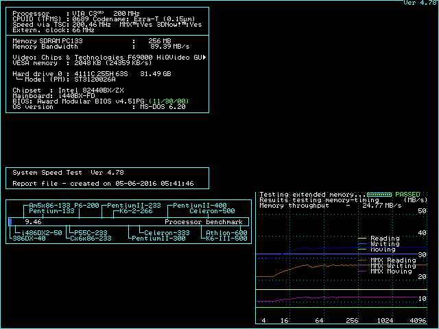

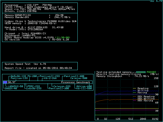

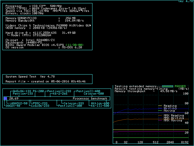

Reply 12 of 44, by j^aws
Continuing from above:
7.17 KiB
2075 views
100x5; 500MHz; L1D
5.91 KiB
2075 views
100x5; 500MHz; L1D; BPD
Around these speeds, it is taking too long to run the memory profile tests in Speedsys, so I've skipped most of them. The speeds below 30pts can be achieved in multiple ways because there are many parameters that can be adjusted...
5.94 KiB
2075 views

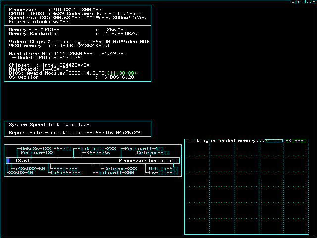

100x3; 300MHz; L1D
5.93 KiB
2075 views
75X6; 450MHz; L1D
5.95 KiB
2075 views
66X16; 1066MHz; L1D
More to follow...

66x6; 400MHz; L1D
5.92 KiB
2069 views

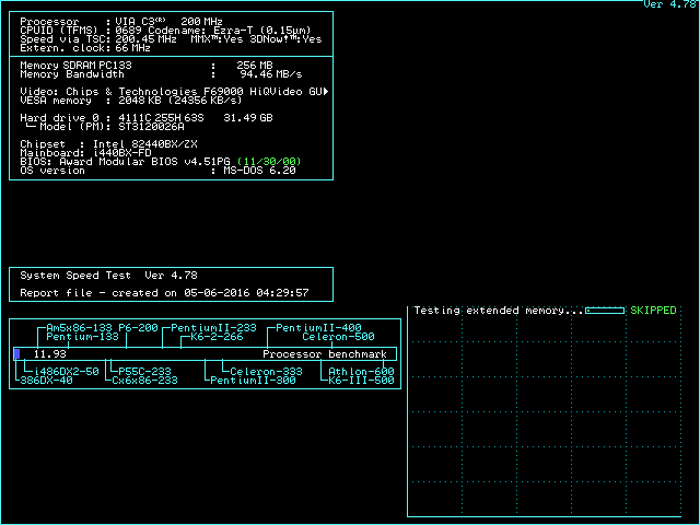

66X3; 200MHz; L1D

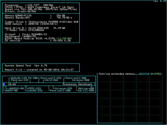

66x3; 200MHz; L1D; BPD
More to follow...
Reply 14 of 44, by j^aws
Continued...
7.28 KiB
2063 views
66x3; 200MHz; L1D; BPD; Slowest BIOS timings
This is the slowest I can achieve in Speedsys - 9.46pts, using the slowest timings in the BIOS. Around these speeds, the accuracy reported by Speedsys can have discrepancies. It is reporting a fast 386DX currently. I normally cross-reference other benchmarks to get an idea on where the CPU is at. For example, Topbench is reporting around a 386SX-25 and so is NSSI. However, Norton Sysinfo 6 is around 386SX-16 levels or slower.
If the board had a 50MHz FSB option, it should hit around a fast 286.
@Clueless1: I'll try to get those other benchmarks for you later...
Time for a break now, and to decide what VGA card I should use - can't decide on whether this C&T F69000 is worth keeping. Any interests in other benches, feel free to request.
