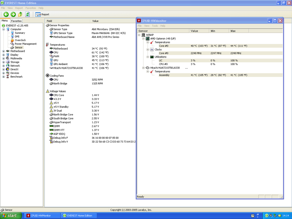

Ive decided to build a Socket 939 system and have decided to go with an Opteron 148 as opposed to an Athlon64 FX. The board is an Abit AV8 (latest BIOS) and the CPU is recognised , however there is one issue regarding tempratures.
the system is giving me 2 different readings for the temperature of the CPU in the BIOS and in Everest shows a temperature of 60C or more under load , while in HWMonitor the temperature is a much lower 40C.
the CPU is using the stock AMD heatsink/fan , and the thermal paste Im using is Arctic Silver Ceramique. Furthermore the board is currently sitting outside of the case (still waiting for that one in the post), so there isnt a problem of airflow.
here is a screenshot of both Everest and HWMonitor giving me different readings (this was after installing and running Quake4 for about 15-20 minutes)
So what is happening with these temp readings? 60 seems pretty high if its really that temperature (the heatsink doesn't feel particularly warm either)
Thanks in advance

Could be reading different themp sensors so they both could be accurate but you will eventually to figure out if they are actual cpu temps or board temps. It is possible that it could be a glitch.

See what BIOS thinks about Idle temp of your CPU, and compare it to what programs are showing you.

as I said the BIOS readings tell me its 60C as well.
interestingly AIDA64 lists both temperatures (refering to it as "CPU" and "CPU Core"

40c sounds too low, but that's just my gut talking.
What is the CPU rated at? The cooler, does it have a copper core? What is the room temperature like? Got cool and quiet turned on in the BIOS and driver installed?

hmm, now that I think about it, the cooler doesn't have a copper core, its completely aluminium.
an ebay search got me a combo Opteron 170 (a dual core) and a stock AMD heatsink with a copper base (guess this one is for Opterons?) for cheap, we will see whether that combo ends up being a bit cooler, Though I do wonder if the performance will be as good as the 148 in games that dont utilize dual cores ,ie most of them (the 170 is a 2Ghz dual core, while the 148 is a 2.2Ghz single core)

110 W CPU?
The 60 to 70c is 95% the real reading. It might be throttling as well.
