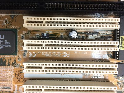

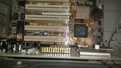

Spotted this on my Asus P5A rev. 1.06... A place/space for a possible SB-Link header.
Does this occour on lower revisions as well, and is there more to it than they "only" planned it?
Anyone know anything?

Reply 1 of 29, by j^aws
Other Super Socket 7 boards have SB-Link headers and work (VIA MVP3), and ALi chipsets should support it (being from the same era). Not all manufacturers implemented the header. Full functionality may differ on PC/PCI (DMA) and S-IRQ (Serialised IRQ) support though. Try soldering a header and see?

There are more than just the header missing.
It has pads for resistors or something else, that are unpopulated.
Reply 4 of 29, by Carlos S. M.
I found a pic of an ASUS P5A rev 1.04, but it doesn't have the SB-Link header nor pads for it
http://mail.lipsia.de/~enigma/neu/pics/mainbo … rd_asus_p5a.jpg
ASUS P5A-B (Baby AT version) seems to no have SB-Link nor pads for it
https://images-na.ssl-images-amazon.com/image … 8L._SL1500_.jpg
Reply 5 of 29, by brostenen
Is it perhaps a buggy feature in later Ali-V chipsets we are talking about here?
Something that was promised as a working feature, and turned out to be a broken one.

I have done it on other boards, and it works. Any missing SMD components (resistors, caps etc) are probably not related to the SB-link at all; the signals on the header come directly from the southbridge chip with no other components needed.

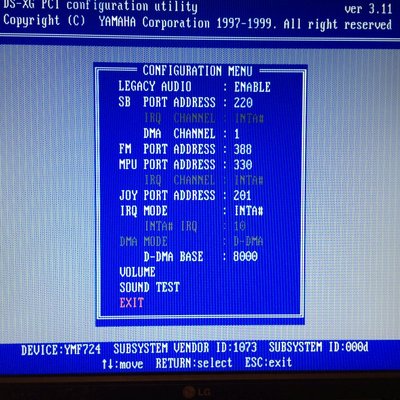

Get a Yamaha PCI (YM724 or 744 based) that has the PC/PCI connector; get a 2x3-pin cable and connect the two (like this one http://www.ebay.com/itm/2-54mm-Pitch-2x3Pin-6 … T4AAOSw5cNYTeiH or this one http://www.ebay.com/itm/181656711487?_trksid= … K%3AMEBIDX%3AIT )
Run the card's SETUPDS.EXE program; if all goes well it should allow you to select serial IRQ as method of assigning an IRQ to the card, and both 8-bit and 16-bit sounds will test well in the setup program.
If it doesn't work you may need to edit the setupds.exe program to add the PCI ID of your southbridge; read about it in my other thread YMF744, DOS, no DMA? (PC/PCI, SB-link tests) (edit YES DMA, read further down)

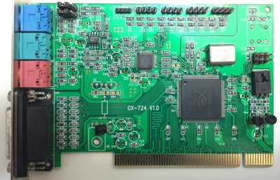

Reply 15 of 29, by mockingbird
Ok, as promised:

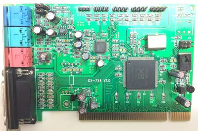

The Aopen 744 cards don't have an SB-Link header, so the other option was this generic 724 card.
275.75 KiB
1660 views

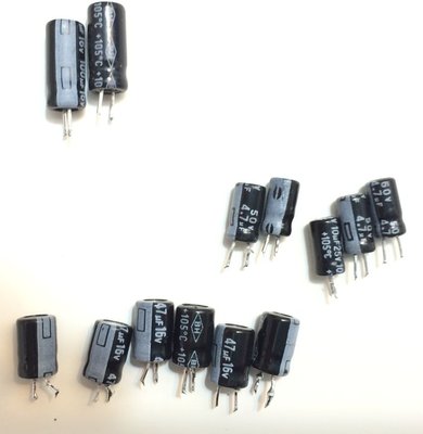

The first step was to remove the old cruddy "BH" brand capacitors that are now over 15 years old.
48.31 KiB
1660 views

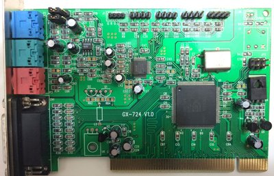

...and here is the card without the caps
278.62 KiB
1660 views

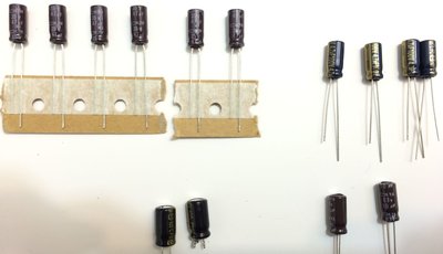

For the replacement caps, we'll use a mix of UCC KZM and KYA series as well as Panasonic FC and FM series
88.1 KiB
1660 views
All finished:
299.13 KiB
1660 views

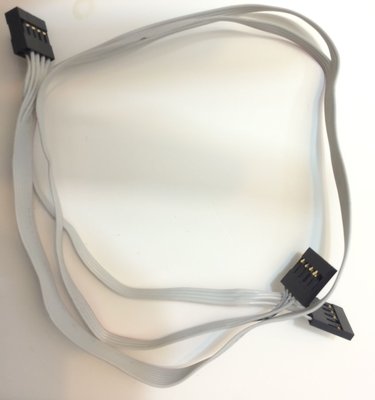

Reply 16 of 29, by mockingbird
and here's the board with the pins soldered in:
339.31 KiB
1659 views
and an old USB header cable... Conveniently enough, one side is split, which is helpful since I can't determine the correct orientation of the header on the card since they populated all the pins. Furthermore, since both corner pins of SB-Link are ground, determining which corner is ground with a multimeter won't help, since they'll both show connected to ground. No worries though. We're not dealing with voltages here, just ground and signal pins, so all that's needed is to swap the orientation in case it doesn't work.
57.63 KiB
1659 views

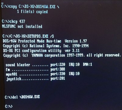

But unfortunately, it did not work:
369.34 KiB
1659 views
134.08 KiB
1659 views
The next step is to play with the device ID as you suggested, but that's it for today. I must say that the quality of the sound output was very very good in the test program. Very crisp and clear.

The large missing component is an impedance matching transformer. For short runs, it's not particularly important. I'd temporarily bypass it with jumpers from the top left to bottom left pad, then top right to bottom right pad. Same with the resistors and caps (R42, R43, C78, C79) as short runs won't be able to pick up too much noise. You can use properly sized zero ohm SMD resistors instead. Last, install the 2.54mm header.
If you need to improve the digital output you can always do so, but this would allow you to start testing.
