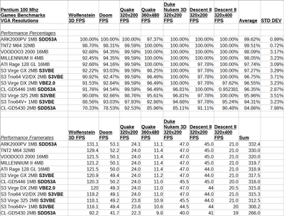

Pentium 100 VGA Results:
80.25 KiB
13278 views
Let's see what happens when we add 100Mhz and MMX to the mix and crank up the resolutions.

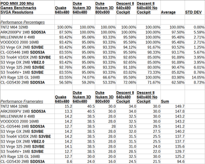

Pentium Overdrive MMX 200Mhz SVGA Results:
69.17 KiB
13277 views

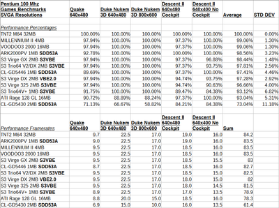

And lastly, how the cards did in SVGA games at 100Mhz:
66.3 KiB
13277 views

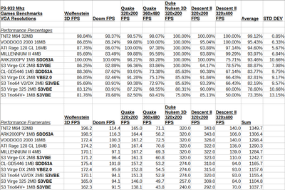

To reduce any CPU bottlenecking and see how these cards perform with more processing power, I tested all these cards in a Pentium III 933Mhz system. The system is a Dell Dimension 4100.

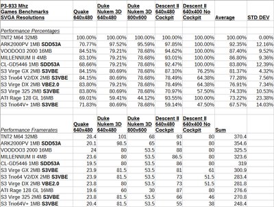

First, let's look at VGA games:
76.79 KiB
13279 views
Now for SVGA games:
63.98 KiB
13279 views

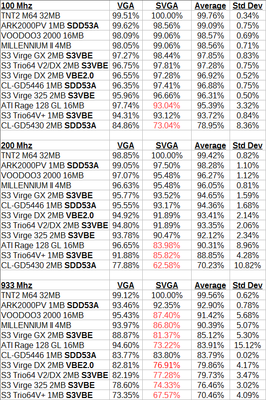

VGA vs. SVGA
I compared overall performance of each card at VGA and SVGA. I also noted in red the cards that had a significant drop (3% or higher STDEV) in SVGA performance compared to its VGA:
70.59 KiB
13278 views
The most consistent-performing cards across all three CPU speeds are the TNT2 M64, ARK2000PV, and CL-GD5446.

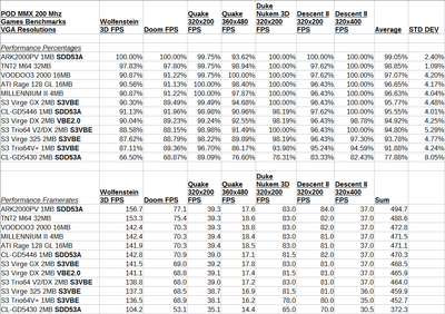

Updated the results in the first post to include performance consistency (standard deviation).
Also added results in the 2nd post on a P3-933 to reduce CPU impact on the scores. There's definitely more separation between results, and the TNT2 M64 overtakes the ARK2000PV with more CPU to play with.

Got an ET6000 and CL-GD5446 on the way. If they are functional as advertised, I'll add them to the results in the first two posts. Made offers on both, and ended up spending a combined $30 shipped for the two. No photo on the CL, so who knows what condition it's in.
Reply 14 of 46, by clueless1
Added results for the CL-GD5446 to the first two posts. Performance is typically somewhere between the Virge GX and Trio64 V2/DX. The ET6000 was DOA, but I got a refund, so no harm, no foul. I'll keep looking for good deals on this card so I can eventually add it to the chart.
Reply 15 of 46, by clueless1
Added Reviews/comments on each card at the end of the 2nd post.

Added Diamond Stealth 3D 2000 Pro results with Virge DX chipset to the first two posts. This is a nice card! It has VBE2.0 built in, which sets it apart from the rest of the S3 cards. It performs nearly identically to the Trio64V2/DX, a little slower than the Virge GX. So the GX is still the fastest S3 card in these results.
Also, since I added the reviews at the end of the 2nd post, I removed a lot of redundant commentary. 😀
