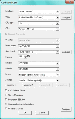

Windows XP works fine in PCem but sound not working. I can't find Sound Blaster 16/AWE32 driver for XP.

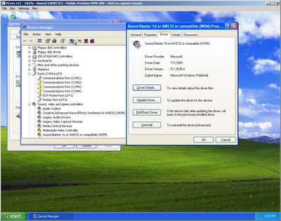

Okay, so I installed a localized copy of Windows XP Pro x86 w/ SP2..
PCem's SB16 card wasn't detected during setup, but afterwards I managed to install the driver manually.
- It was the same one which leileilol mentioned earlier in this thread.
After this, I entered control panel again and made the mixer icon visible. And that's it!
I wasn't required to change any resouces (IRQ/DMA/Port).
For testing purposes, I played onestop.mid and a few wave files using Mplayer2.
