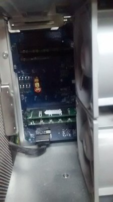

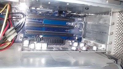

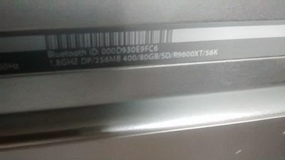

Reply 5 of 28, by matze79
It has 4 RAM Slots and PCI-X for sure 😀
Apple says ECC RAM is ok, but i can't find Information about DIMM Size.
Also 8Gb supported.. but i have only 4 DIMM Slots 😳
EDIT: only DDR2 Models support ECC ?
Seems Page Information is incomplete ^^
Too bad i have no ECC RAM to try it.

I reckon those are PCI slots. They are 3.3V 64bit PCI slots and have the same appearance as 64bit PCI-X slots.

So you mean only 32bit Part is connected ? hmm (EDIT: full 64bit is connected)
PCI-X = 64bit PCI or not ?
Where is the difference ? PCI-X vs 64bit PCI ?
Reply 8 of 28, by bjwil1991
PCI-X is a 64-bit data bus that is backwards compatible with 32-bit PCI cards and supports the following voltages: 3.3V, 5V, or both (universal), depending on the slot itself as displayed on this site: https://superuser.com/questions/384640/what-i … -and-pci-x-slot
There is no difference (generally) between PCI 64-bit and PCI-X in a matter of speaking.
Reply 9 of 28, by lazibayer
Conventional PCI tops at 66MHz 64bit, and PCI-X 1.0 pushed that limit to 133MHz 64bit.
PCI-X differs from PCI in more aspects than speed and bandwidth. It added split-response mechanism, message signaled interrupts and registered i/o on top of the conventional PCI.

Anyway the 4 RAM slot models are PCI and are stuck at 4GB of RAM. 8 RAM slot AGP models are PCI-X and can do 8GB of RAM. The PCIE models have 8 slots and can do 16GB (2x8GB) but I have no idea if you could actually need all that RAM.
