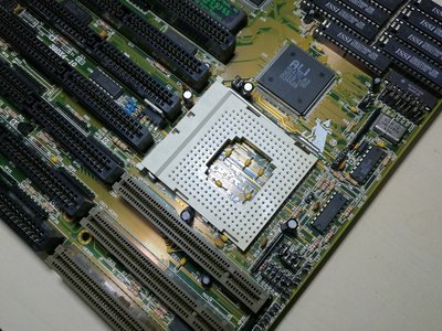

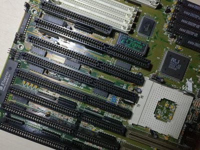

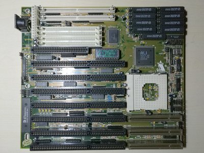

I buy this old one for retro DIY and benchmarking to get the best 486 system. It's come with a TI486DX2-80 but can not get working ( no display and I have plugged in a POST debug card and the code show "no" means CPU not work at all ), I pull out CPU and get it work on another Octek Hippo 10 mainboard with AM486DX2 jumper setting.
So, I am googling it hard by no any clue, anyone have this board or any hints about jumper setting is welcome.
It's look good, and no any jumper setting info on board.

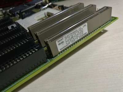

Reply 3 of 5, by Roman555
Such an interesting VESA mobo with only M1439 although it is usually coupled with M1445. Perhaps Internet doesn't know even the manufacture "Saint Electronics co. ltd"...

Great site, I searched in text index page but no luck.
Motherboards had a lot of different names/"brands" back in the day. You have to look at the pictures, which looks like a lot of work but you can scroll through them fast if you remember the ram locations, slots and cpu placement.
Reply 5 of 5, by Roman555
It would be nice to read the BIOS chip by a programmer and search mainboard model by BIOS-ID extracted from the image.
