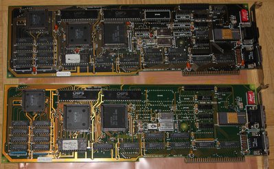

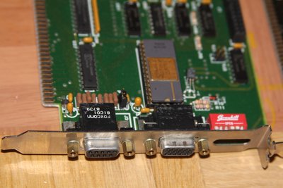

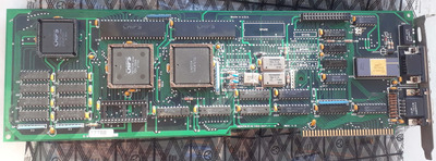

Quick presentation of my Heath P/N 150-307-3 Rev 1.33 and P/N 150-307-2 Rev 1.32 8-bit Video cards before going back to storage...
1.61 MiB
2941 views
747.77 KiB
2941 views
After Anonymous Coward made me aware its EGA not VGA I took a closer look at them. I think its quite unusual as other cards with EGA/VGA connectors are VGA but support EGA monitors, like the ET3000 cards. So these ones are different.
Jumper setting for VGA display:
1 open
2 close
3 close
4 open
5 open
6 close
728.99 KiB
2941 views

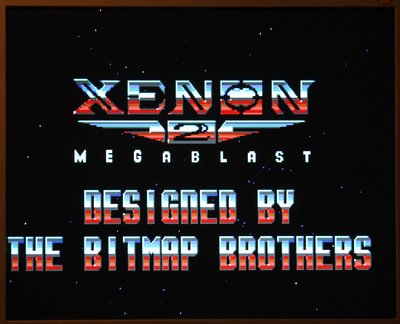

They do not support 256 colors, but the 640x480x16 VGA mode, so its possible to run Windows in VGA resolution. Same as for other C&T EGA cards.
Xenon 320x200x16

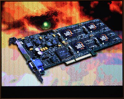

640x480x16 VGA
1.91 MiB
2939 views
640x350x16 EGA - same image
1.63 MiB
2939 views

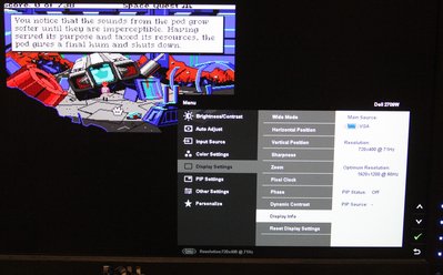

Installed the card in my main 286 and can confirm its 100% EGA with a EGA-to-VGA converter at the end 😀
Some results:

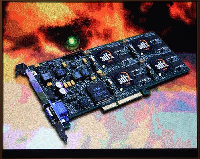

EGA Game (320x200x16): Output 720x400 @ 71Hz (seems to make some upscaling here)
1.14 MiB
2898 views

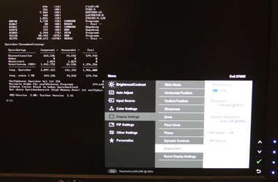

VGA Mode 12h (set with debug.exe): 640x480 @ 60 Hz
740.88 KiB
2898 views

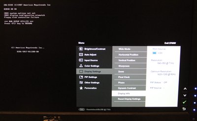

Boot and DOS Display: 640x350 @ 71 Hz
652.06 KiB
2898 views

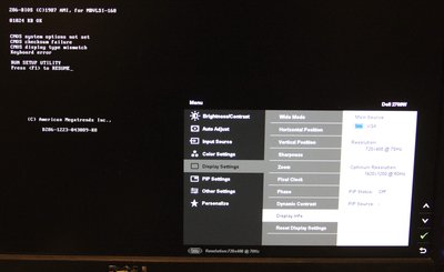

Compared to a standard 16-bit VGA card in another 286 PC:
Boot and DOS Display: 720x400 @ 70 Hz

Love the card! The spare IC pads are funny. What spares would have gone there?

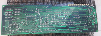

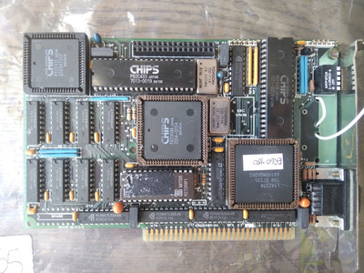

Attached photo card
What does your card do? Does the PC boot without picture? Or doesnt it post at all?
I receive a beep signal for no graphics card
I have a 1.33 card, I tested the BIOS chip on it and it works fine.
What size of EPROM do you use?
27256
There are several differences in the board layout.
But I think problem in PAL logic, they differ in firmware versions 1.31 and 1.33. Therefore, the bios is not suitable.
