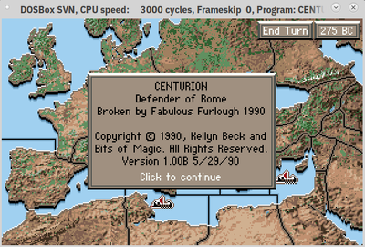

FF, I just noticed this in the About screen while doing some play testing. Thought it might bring back some memories...
