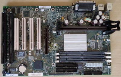

At some point I managed to acquire SB16 Value CT2770 with authentic OPL3 FM chip and the stage was set to go all the way in with 440BX adventure. Then shortly after that used Intel SE440BX-2 MB with 500 Mhz Katmai and 128MB SDRAM popped up at local auction site and went for it. As usual with these sites there is always one other fellow retro enthusiast who drives price up. I got full set at 55EUR.
I have no problem mixing up modern parts as long as MB/GPU/Sound core system delivers authentic outcome. So my first Slot1 iteration shaped up as follows:
CPU: P3 500Mhz Katmai
MB: Intel SE440-BX2 (Made in Ireland btw)

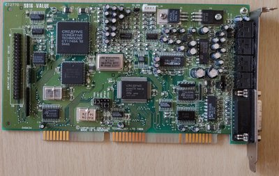

Sound: SB 16 Value

Since I bought SB16 Value edition w/o wavetable header I planned to get external MIDI device. SoundCanvas was my initial target. Well before I seriously started to hunt down on ebay. Pricey!! So I decided to switch to modern better sounding in my opinion alternative - Serdaco’s X3MB. It turned out that CT2770 has buggy v4.13 DSP with external MIDI sound.
SB16 is also bad Win98 card. It has issues with 48khz->44khz sampling rate conversion while watching my old concert DVD collection.

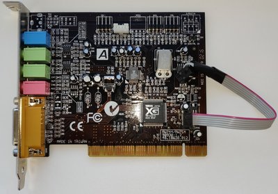

Since I didn’t want to give up authentic Yamaha OPL3 sound I went for AOpen AW744-II. It’s 2002 card so sound output is cleaner than any mid-90 SB with almost perfect SB Pro 2 compatibility. I even hard-modded SB-LINK connector there in order to enjoy TSR free sound experience in DOS mode.

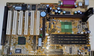

Decision time: By now I had almost 2 sets of each component except the motherboard. So since Slot1 is timeless hardware for DOS/Win98 nostalgia seeker and old components will eventually fail and for sure they are not getting cheaper in the future, I decided to go for ultimate 440BX motherboard - Asus P3B-F. Again after patiently waiting for a couple of months I managed to snatch one for only 34EUR+shipping and it has been working now for couple of months perfectly.
790.59 KiB
1232 views

MB: Asus P3B-F

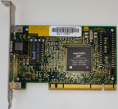

Net: 3C905B-TX-NM Fast Etherlink XL PCI

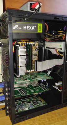

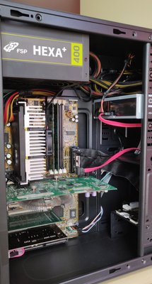

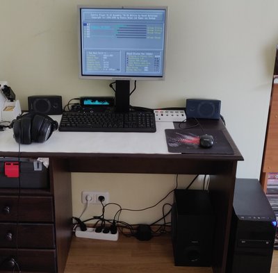

System and setup pics:
514.46 KiB
1229 views
163.76 KiB
1229 views

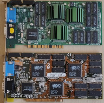

Every respectable DOS/Win98 retro rig needs native Glide card. I had Diamond 3DFX card back in a days so I wanted one for my build as well. Well unfortunately both 3DFX2 I bought from ebay are not working. One is completely cold and another one is detected by windows, but main chips are cold. So I learned my rather costly lesson to set my expectation buying old PC parts from ebay. Search for 3dfx is therefore suspended atm.

Reply 2 of 7, by jaZz_KCS
Maybe you want to upload some more close-up high resolution pictures of the afflicted Voodoo2s. Not for me personally, but there are a lot of very well versed 3dfx fanatics - I MEAN connoisseurs here on the forum which might just be able to see what may be wrong with these cards by merely looking at them.
Although the symptoms you described sound more like internal problems.
Reply 3 of 7, by dries_86
I'm by any means not specialized in 3Dfx cards but it looks like both cards have some damage on the PCI connectors . Could have nothing to do with the issues though. And the general state of the cards is pretty bad, especially the bottom card. I hope you purchased them as untested / not working ? Otherwise if you paid by Paypal I would request a refund !

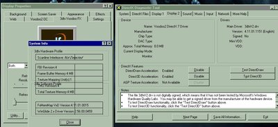

Well it looks like my 3dfx side story developed a twist!
It's literally twist, because if you look closely at upper Gainward card top chip with heat sink is little bit twisted. I noticed that when I bought it, but at that time I missed the fact that 4 legs were also detached. I noticed it only yesterday when I was thinking about taking hi res pics for this thread.
So I managed to solder them back and test card again...
--- and it started to work. YAY!
However there seems to have a problem:
110.99 KiB
1138 views
Gainward Dragon 3000 is 12MB card. I think texture memory should be 8MB not 4MB. If that twisted chip is one of the TMU-s then it appears that it isn't working properly even after my solder fix. Then again chip is hot to the touch like the rest of heatsinked chips so it's doing something for sure.
Weirdly enough Quake 2&3, Half-Life, Final Reality and even 3DMark2001SE worked flawlessly without any visible errors in 800x600 16bit modes.
Edit: Nevermind. After another round of basically feeling with needle each and every TMU chip leg I found the culprit - another leg was loose.
Now it shows correctly 2 TMU-s with 8MB texture memory. YAY I got my 60EUR back!!

A little update!
394.71 KiB
914 views
+ Gainward Dragon 3000 (12MB Voodoo 2) - since I got it working
+ Soundblaster 16 Value (CT2770) - since I want 16bit card in DOS mode
+ Samsung SH-S182 IDE DVD device - It has dedicated audio out for DOS red book CD games and it's IDE. Less clutter, no need for SATA-IDE adapter.
My monitor sports dual input. So I do not need to use pass-trough cable. So no 2D hi-res video degradation.
Getting 2 Audio cards working in DOS turned out to be more tricky one. Creative PnP DOS tools refused to work in DOS 7. So I let windows to manage resources. Still in order to get typical configuration I had to choose manually resources.
So DOS looks like:
SB16 - A240 I5 D3 H5, MPU401 disabled
Yamaha 744 - only OPL3 388h and MPU401 is enabled for my external MIDI module. O plan to add SB-Link pins to motherboard then I will enable SB Pro2 at A220 I7 D1.
I'm using modern external 5 channel portable sound mixer so I can avoid looping sound trough sound cards probably inferior on board mixers.
