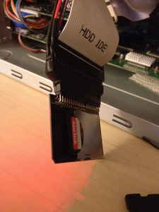

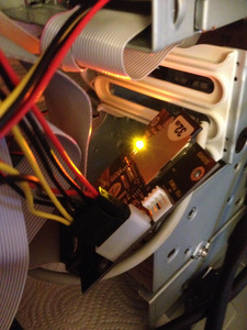

Reply 12 of 28, by jaZz_KCS
I have one of those adapters you mentioned (the CF-to-SD one (red)). Although it works on newer machines, I never could get it to work with any SD card on older systems. This might not be the same case here though, but still. For me, either pure CF-card or SD2IDE worked fine. But an SD card in one of these adapters never worked for me, maybe they are to blame, as you now go adapter on adapter, like I did.
The ones that always worked for me were these: (in maybe one out of 10 systems, I couldnt have anything else on the same IDE channel, but 9 out of 10 times everything works...
Here is an example shot of a VIA KT133A board with an XP2100+ running two of these adapters (both sizes, 2.5" and 3.5" (I didnt have anough 3.5" adapters)). As you can see the systems works fine with these..: (given the fact that you already have one of the known to work CF adapters, I would just go and see whether you can source a fittable CF card. I think the adapter on adapter link is to blame.)

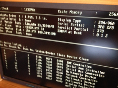

OK, so I tried one more time.
Here's the current configuration:
- SD/CF is primary master on the 40 wire cable.
- 80Gb HDD is secondary master on the 80 wire cable.
- DVD is secondary slave on the 80 wire cable.
Leaving BIOS to autodetect the drives results in this:
l1fqqQRt.jpghttps://i.imgur.com/l1fqqQR.jpg
Manually setting C/H/S in the BIOS like this:
CMViYhxt.jpghttps://i.imgur.com/CMViYhx.jpg
STILL results in this, even if the values are correct:
n7qZTX4t.jpghttps://i.imgur.com/n7qZTX4.jpg
Here's what FDISK sees:
lq1YP7zt.jpghttps://i.imgur.com/lq1YP7z.jpg
And what WHATIDE reports:
oxCXd5Et.jpghttps://i.imgur.com/oxCXd5E.jpg
The only odd thing that I notice in the WHATIDE report is that 1Kb sector buffer.
Other than that, I'm at a complete loss.
